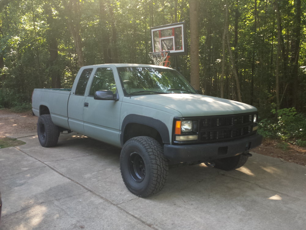

OK, so I have owned tons of gassers, but this is the first diesel I have ever owned. It is a 6.5L turbo in a 98 2500 Chevy truck.
I've heard to change the oil and filter every 4k miles without fail. I'm guessing that is a correct statement.
What other maintenance do I need to keep up? I know there is more than a standard gasser, but not sure exactly what and at what intervals. I know fuel filter and stuff like that, but how frequent?
The truck has new heads and head gaskets, new injectors, new PMD (relocated), new fuel solenoid, new thermostat and all that stuff, etc.
