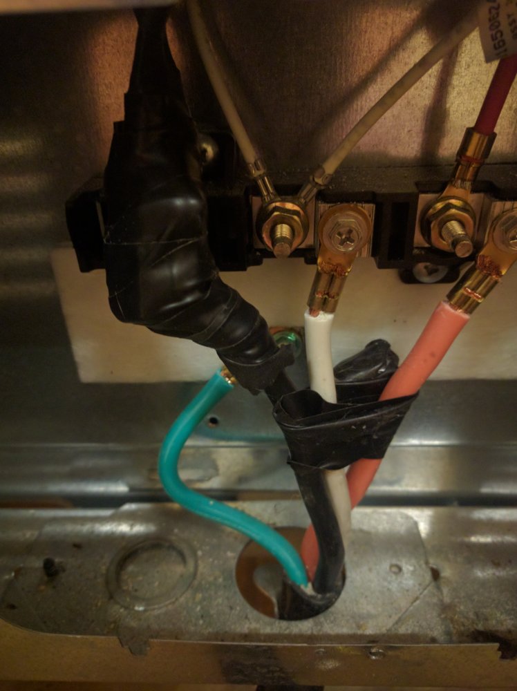

Well after taking apart yoshio the fire shooting range to replace the board the ugly issue came to light .
Fail for me for just not checking before ordering parts.
Double fail on Frigidaire for not checking factory connections at the terminal block. There was slight play on one of the lines that resulted in arcing that melted the lug off the bus thus letting it arc on the back cover. That has cost me about 150 in parts for thier failure. Anyone need a good control board for a Frigidaire range? Btw repair is split bolt and rubber tape and electrical tape.
