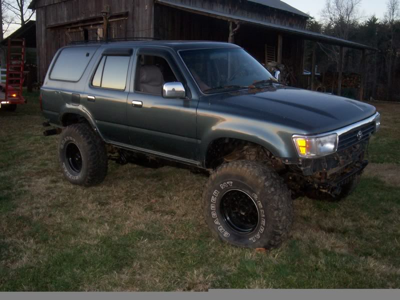

Picked up a new project yesterday after selling my old 4runner a few weeks ago i just had to have another one, its a 93 4runner, blown up v6 motor, still ifs, and 35" MT's.
Plans:
I want to try to make a DD weekend rig depending on axles and if i decide to sell my cummins dodge and if my current toyota sells
This is going to be a slow project until i sell a few vehicles to get some money
-4bt cummins to replace blown up motor or possibly a free 360
-th400 tranny and dual toyota cases
-3 link front probably 4 link rear (not sure yet)
-Not sure on axles probably 1 tons possibly 2 1/2 tons
-36-40" tires probably Iroks if 1 tons, 46's if 2 1/2 tons
-Cage the outside so my kid will have a junglejim to play on:lol:
Heres one pic, ill get some more up tomarrow my computer is being really slow tonight:

dag, i already miss it...she looks good clean doesnt she? give me a holler if you need any help with any bodywork or making some bumpers for it im about to make some for the zuk at a neighbors shop.
its got a 3" body lift and im not sure if it has a suspension lift or not, i think it has a small suspension lift. To tell the truth i havnt touched it since taking it off the trailer yesterday. I think i may start building the hangers this weekend to put an old toyota solid axle under the front for now and i may try to get the engine warrantied at toyota until i can get the money to get the 4bt. I have a lot of plans for it but not a lot of money to start it.

Nice 4runner, I would love to build one of those. Keep us posted on the build.
Glad to help out. Looks like a great project.
