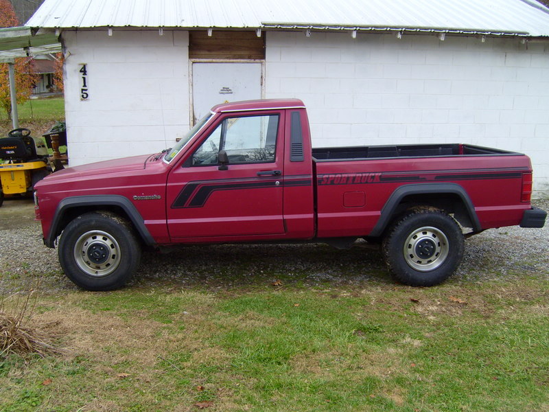

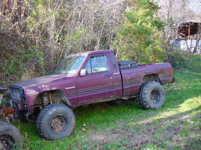

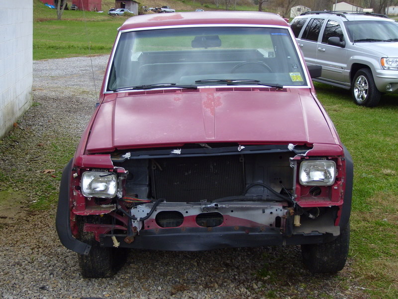

So I found a couple of rigs to splice into one to start the build. First an 88 MJ 2wd, with a TBI 2.5 with slight front end damage. Next, a stripped 84 XJ with a 3" lift, 33's, AX4 and 231 case. I already have a D30 to get it rolling for now laying in the shop. $300 for the MJ and $400 for the XJ.

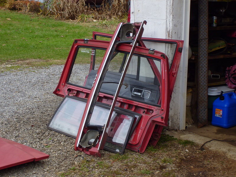

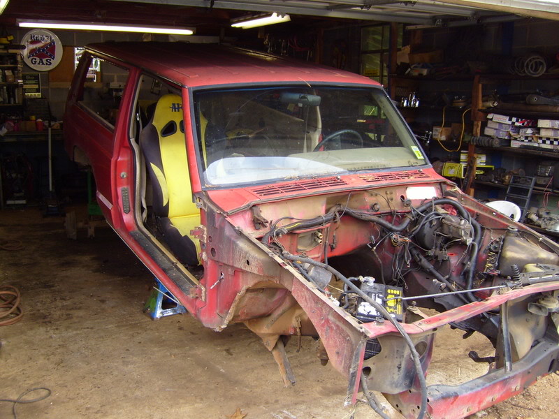

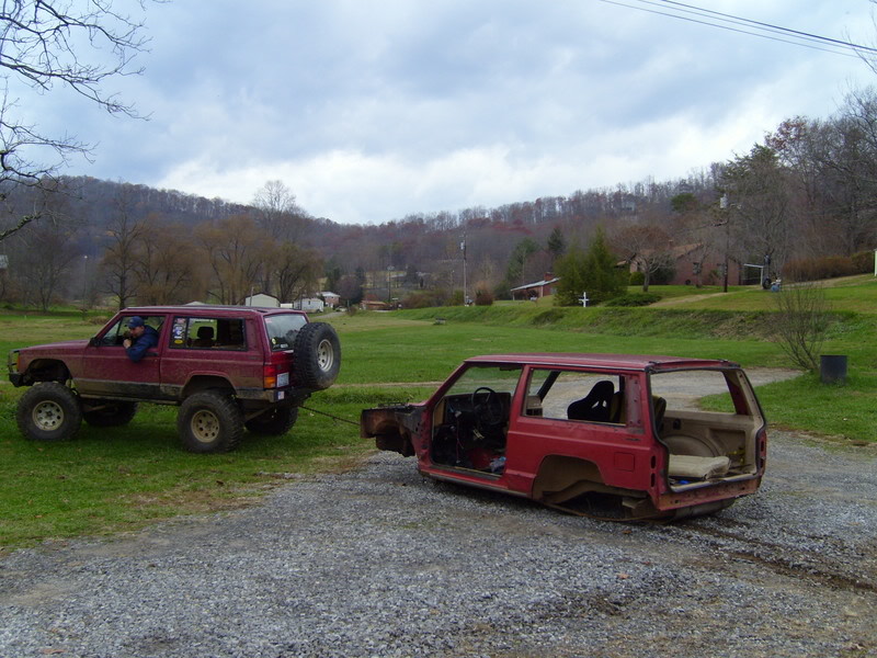

So 35xj and I spent about an hour today stripping the XJ to rob parts for the MJ, here's some pics...
MJ
MJ2
XJ Strippin'
Parts for the MJ and some glass for my beater XJ
And towing off the remnants
