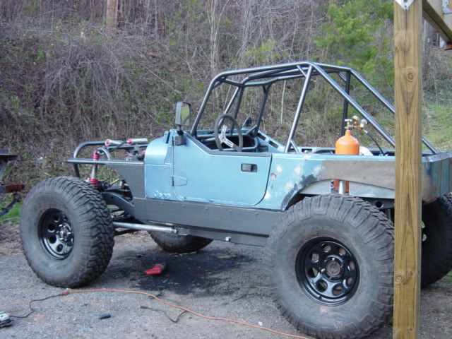

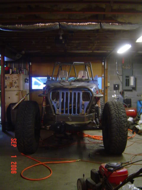

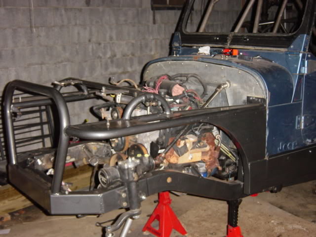

well, the buggy is now at its new home, and the new one is underway!
what it is,

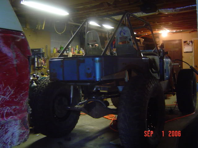

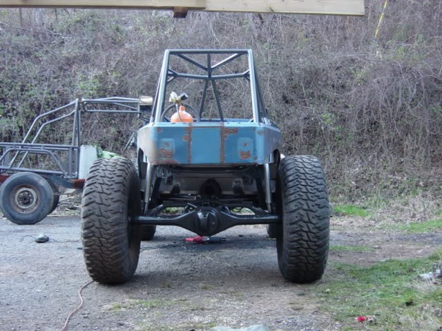

91 yj. narrowed 12.5 inches. floor/firewall cut out, replaced with alu. dovetailed, rear frame cut off and replaced with 2x4. all alu links, 4 link rear, 3 link front with panhard. yota fj 80 front, taco rear. both e-locked. sway-away coilovers in the front, fox airshocks out back. 40" mtr's (for now)
100" WB, 21" belly clearence, 65" to top of cage.
will be getting a 4.3/ t350/300 in the next few weeks.
I think it'll work!
today, i chopped the hood to give it more rake and moved the grill, filled up the airshocks, sat in it for a while:huggy:
yeah, it'll be gettin a set of the 80 longs. next winter it'll get a rear steer axle built, also using 80 outers. share the spare's. the lower links are all the same length, so i can share a spare, and the driveshafts should also be swappable!
That thing is bada$$, you don't realize how small it is until you see it in person. I guess you decided on the running gear now.
yeah travis. running gear is picked out. I guess!

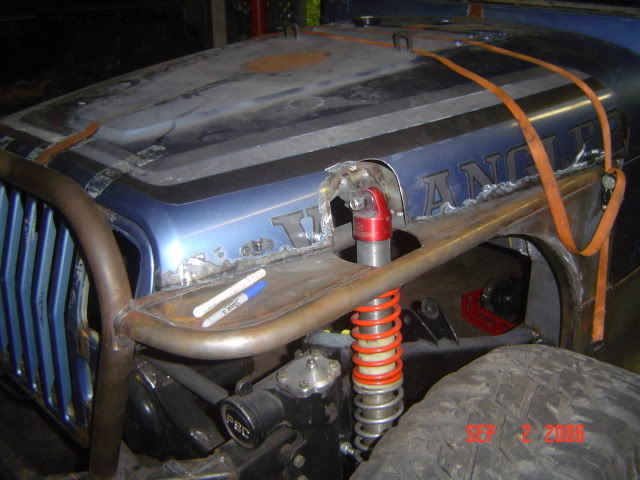

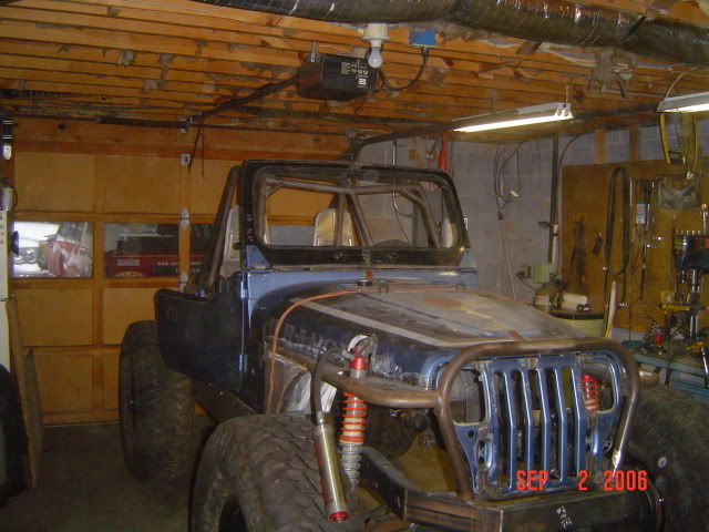

got a little more done today. cut a perfectly good windsheild down to fit

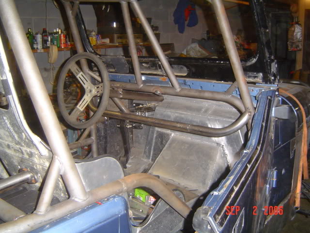

did a little work on the dash

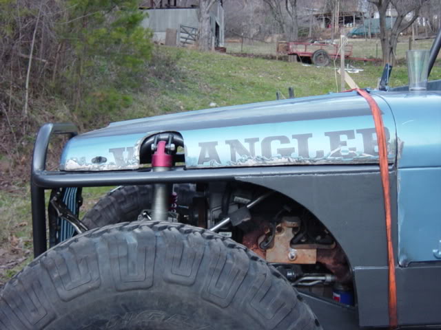

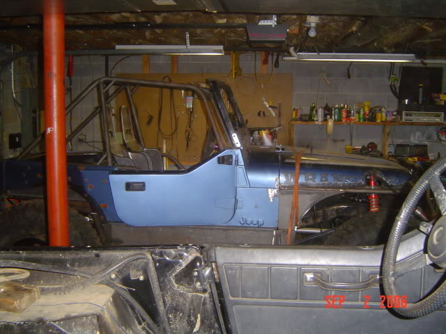

a little more work on getting the lower hood line to line up
here's the hood line from the side
and i'm sure somebody is wondering "why not 60's?"
its coming along

Nice, that clearance is awesome. W/S looks alittle odd on there though. And I love the way you cut the hood down.

and travis, the windsheild does look strange in the pics. but in person it looks "right" its funny to look at mine and Eriks side by side for comparison.
got the steering hooked up today. started planning the ram mount. did a little gusseting, looks like i'm picking up motor tranny tomorow!

i guess its time to do a little update!
Got all the drivetrain in it. 99 vortec 4.3/t-350/300
got the tube/frame/axles all painted up!

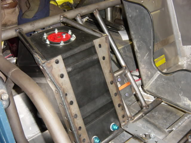

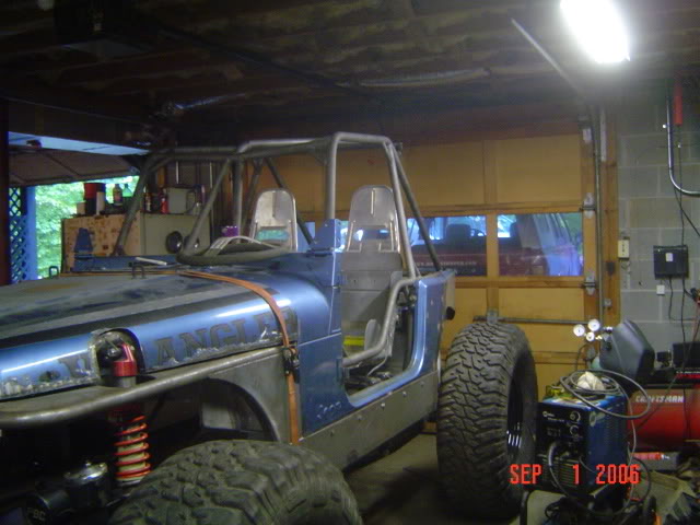

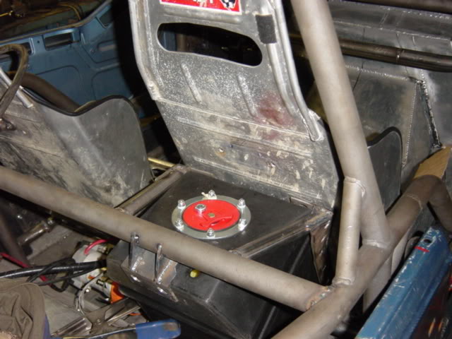

Got the fuel cell positioned out of the way to allow as much "bed space" as possible. moves the pass seat 4" forward of mine. (girlfriend wanted to be able to touch firewall) so it worked out well
Got a little more cut out of the hood got it a little lower in the front

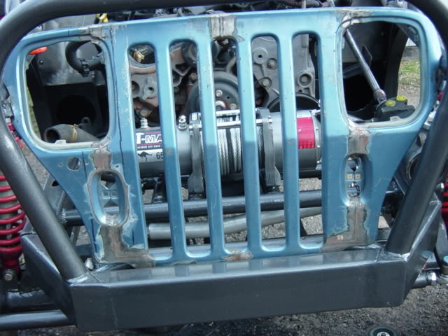

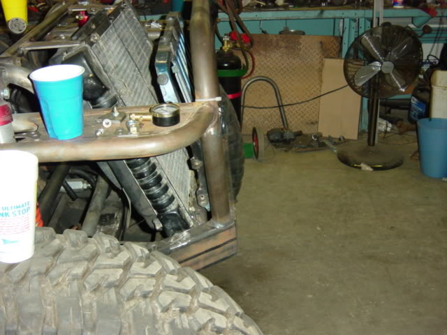

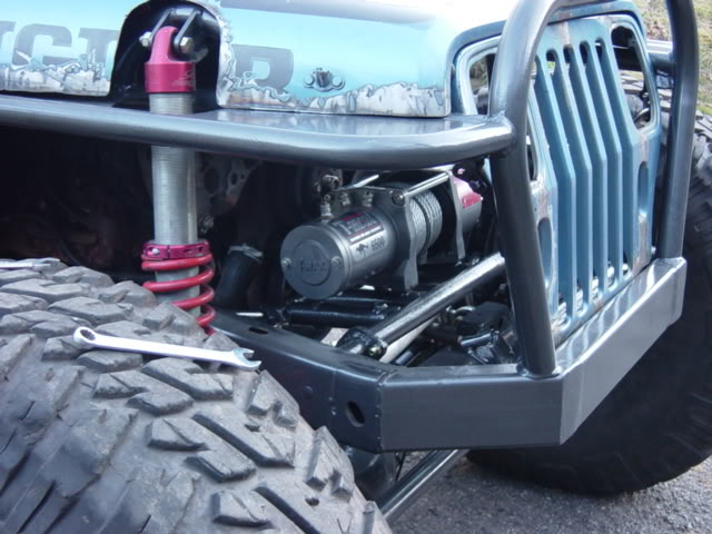

got the winch mount finnished up. it sits behind the rad/electric fan and the rope will come out of the front bumper:huggy:

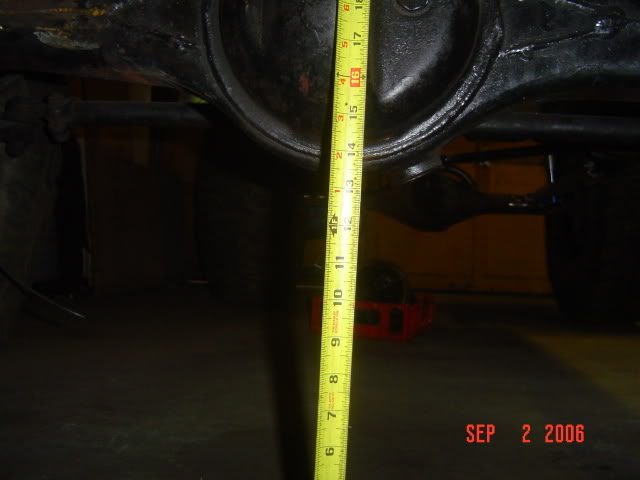

got FINAL ride height figured out!

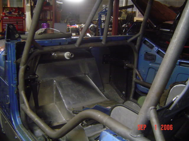

question?

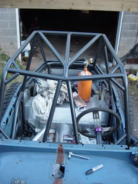

does the cage need a diagonal?

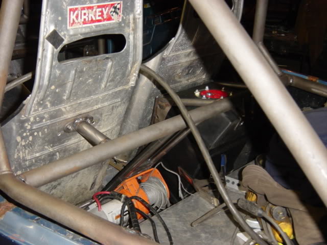

Cage is only 36" at top, not really sure that it needs anything, but i had thought about putting a tube froom the upper pass corner node down to the driver lower. pics show the seat bar/sholder bar. All are 120 wall and pretty structural.
also got the rear winch mount built. Winch is low and centered in the rig
cut 5" from the front bumper (don't need it with the winch under the hood!
That thing is looking sick.. realy unique!
I haven't looked much at Kirkey seats, but are they supposed to be mounted like that? Only reason I ask is that imagine the forces of your body bouncing should you wreck hard.. seems if you have backward motion, the seat could deform around that mount, which would really f-up your back.. :eek:
I was thinking the same thing, it just looks " wrong "
The rest of the rig looks sweet though !
yeah, i have a plan to fix that. does it need a diagonal in b ack of the cage???
