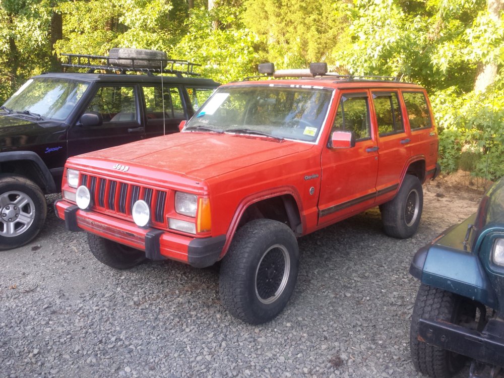

So bought this Jeep at auction, had a clear title and it said it didn't run and had mechanical damage. Got it dirt cheap and figured it would be a good parts Jeep from the looks of it. Well, got it to the shop and did some rewiring and it fired up. Runs like hell and raps like crazy, low oil pressure, blows smoke, all that fun stuff. On top of that the whole frontend was bouncy and rattling and it honestly sounded like the axle was shot. Got under it and looked around and realized that the front shocks were missing the lower bushing and they weren't tight up top and were just slapping around.
Already has what I believe is a 3" Rusty's lift, front doors have been rigged up to be removable, and has some lights wired up. The body is fairly straight except for the driver's front fender. It really is too solid of a Jeep to part, especially with a clear title. I really wanted to build an XJ, so figured why not do a cool shop build. It is going to be a long slow process because most of my time needs to be spent making money in the shop and not working on my own junk, but I am going to throw some stuff at this to build it up nice.
Will probably keep the Rusty's 3" lift for now, eventually go to a 4.5" lift. I have a nice set of 16" ProComp wheels here on a wrecked ZJ that I am going to run on it. Probably try and squeeze some 33s, or at least 31s for now. Might run an XJ Dana 44 I have here, lock it and regear it. Front I'll build a non-disco D35 I have here, lock and regear, strengthen a bit. Then I am going to build half doors, fab up some bumpers, and do some other stuff to it and take it wheeling.
Oh, and the engine is going to be a 4.6L stroker. Going with an HO motor out of a ZJ I have here and stroking it, going to run the newer intake and exhaust with the Renix ECM.
Going to leave the AW4 and do a SYE on the 231 tcase.
And probably will convert to a 97+ frontend when I get a decent one in here, just sold the one I had here right before I bought this. I might keep it as is too, kind of like it both ways. It'll be red with black accents no matter what I do.
So here it sits behind the shop. Probably will sit here for a few weeks till I can move out some stuff and find some time.
