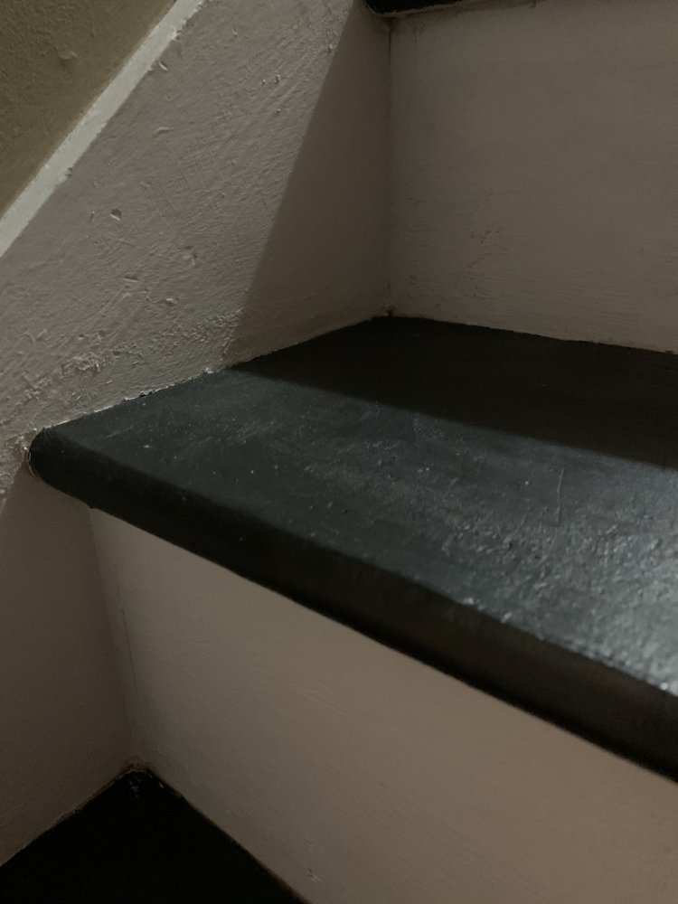

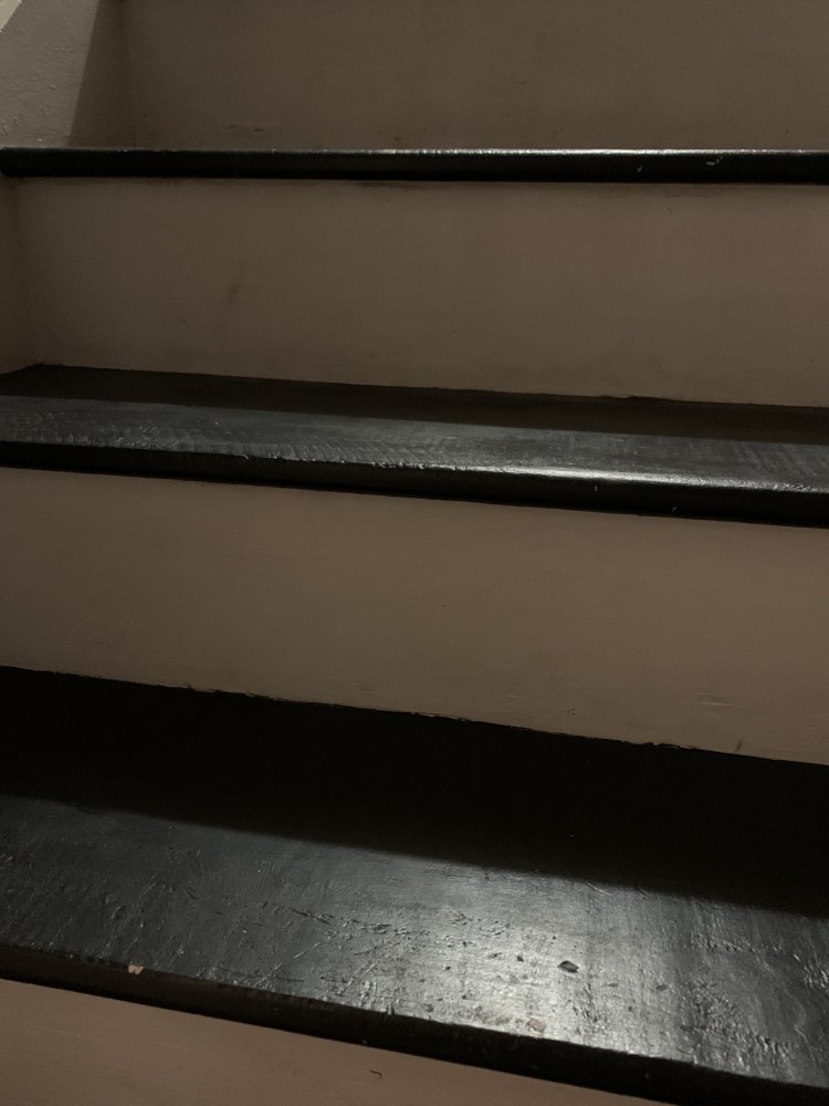

Here are a couple of quick pics. Don’t know if this will help determining anything or not

What sort of house is this? The side stringer suggests those are prefab stairs, builder-grade stuff.
Id bet money you loosened them whenn hou pulled the carpet.
But back with them being painted they are cheap enough to knock em up and replace.
@skyhighZJ how would you screw treads down?
Handrail spindles attached to the treads? If not, I'd think about pulling the treads up, put down some PL adhesive, and then screw back down. Plug the screw holes and repaint. (But...that skirt board might be cut to fit over/around the treads (that's they way they did my mom's house in 1956), and might cover some nails, making it more time consuming and invasive.)
If there are spindles attached, then you got a lot more work pulling the rail. I'd probably drill and countersink some screws (NOT drywall screws) and plug/paint. Knock it out in a couple of hours...if it doesn't get rid of all the squeaks, you don't have much time or money invested. If some steps are louder than others, start there to see if it's worthwhile. Get your heaviest buddy (DO NOT ASK YOUR WIFE, that won't go over well) to stand on the tread you are screwing down.

If they were 2x treads designed to have carpet over them with the stringers under especially if their was a center stringer it’s not hard to screw and glue the treads to the stringers. But, if he is leaving them exposed (painted) it wouldn’t be very appealing. It doesn’t take much to cause a squeak between lumber like that though. IMHO I wouldn’t want open painted stairs as the slip hazard is too high but to each their own.
Spindles are not connected to the treads.
