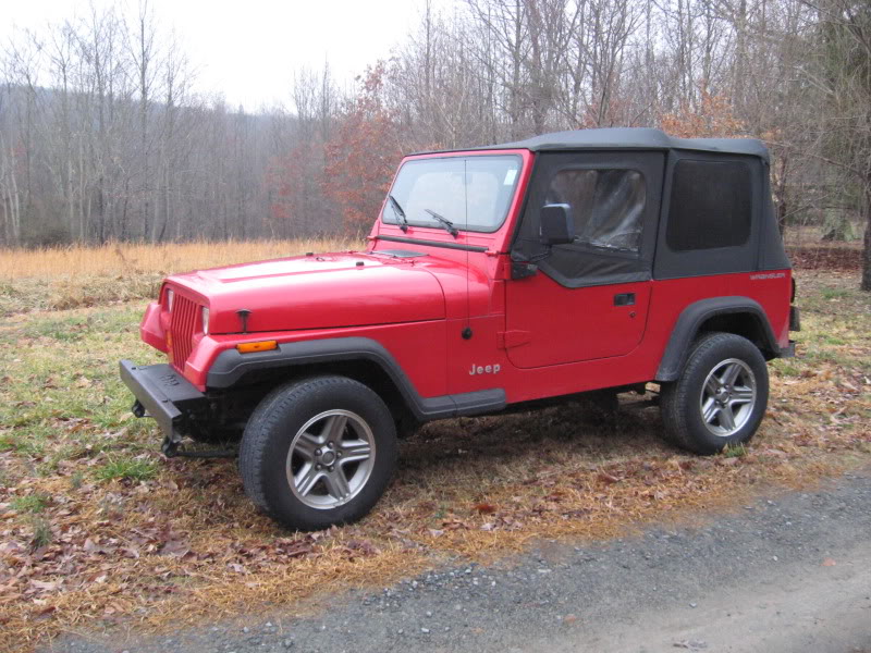

Hey guys, newbie here. I picked it up last week..
99 Jeep Wrangler TJ, 2.5L I4, Intense Blue, fresh motor (less than 500 miles on it), 76k on body, 33" bfgoodrich all-terrains. new exhaust, bestop, PIAA lights, detroit locker front and back, 3.5" suspension and body lift.
full size pic: full res. pic here
honestly, I don't know the first thing about Jeeps (I am a chevy guy) other than what I have been reading online and on jeep forums the past week or two. im trying to find out more about my lockers, and need to do some basic work (brake lines replaced, fuel pump issue? (still havent diagnosed it), some under the hood cleanup) and he also gave me a new steering stabilizer when i bought it that I need to install. I guess I will learn as I go..
