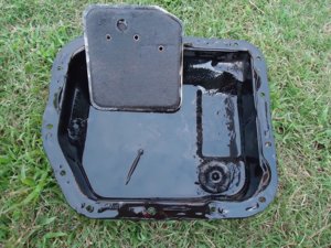

I finally had a chance to work on it yesterday. After numerous times of trying to throw it in reverse I finally caved in and pulled the pan. When I got it off I could immediately just see it was full of metal shavings, there was metal bit and pieces just hanging off the valve body. The filter was was just full of metal, in the pic you really can't see how bad it is. Needless to say looks like I'm going to be replacing it

So was the valve body
So was the Valve Body the problem?
