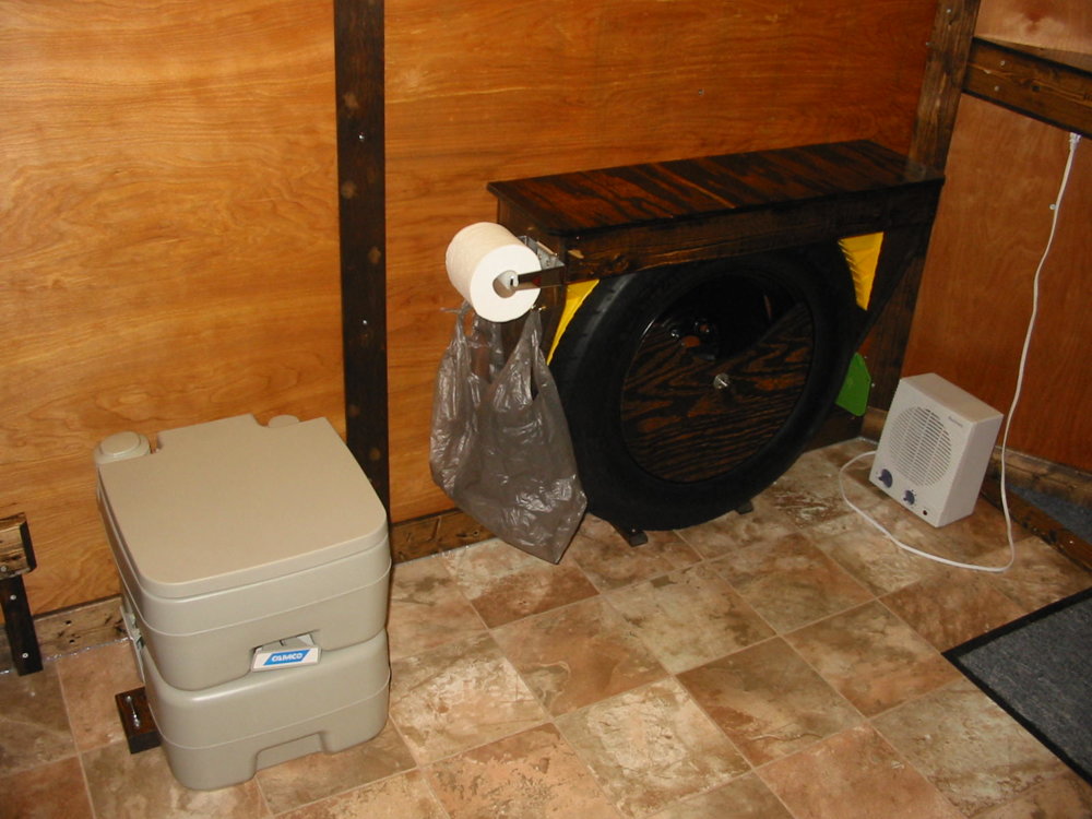

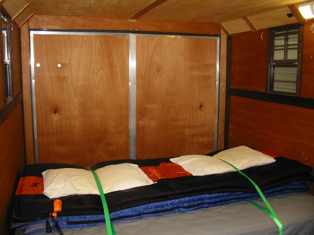

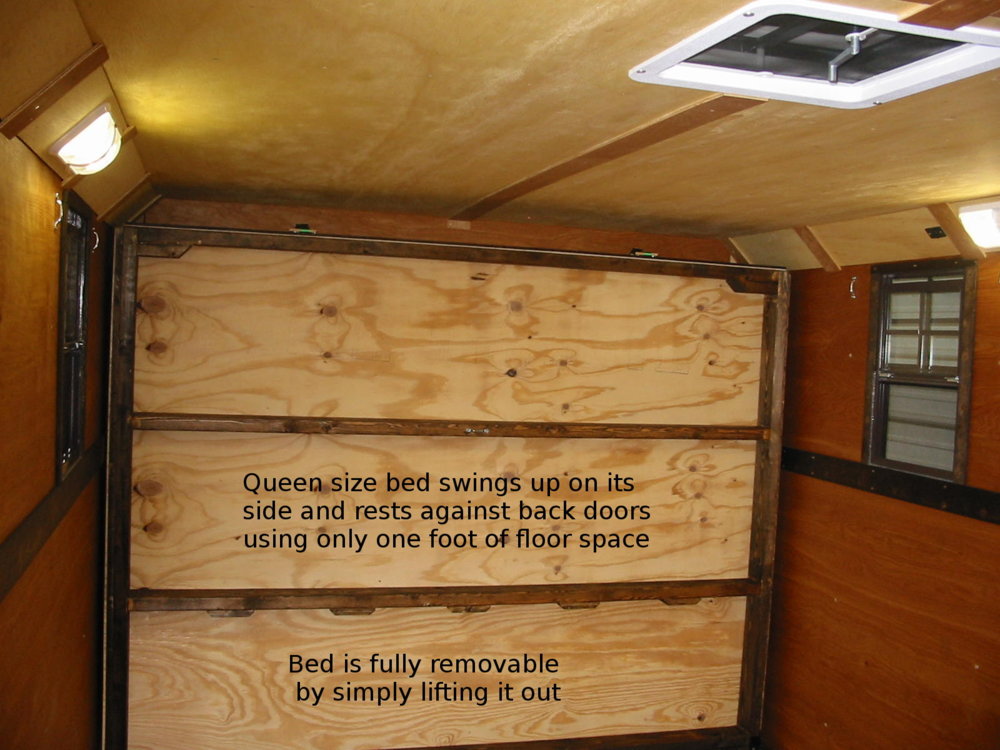

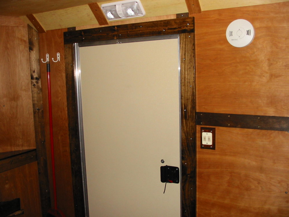

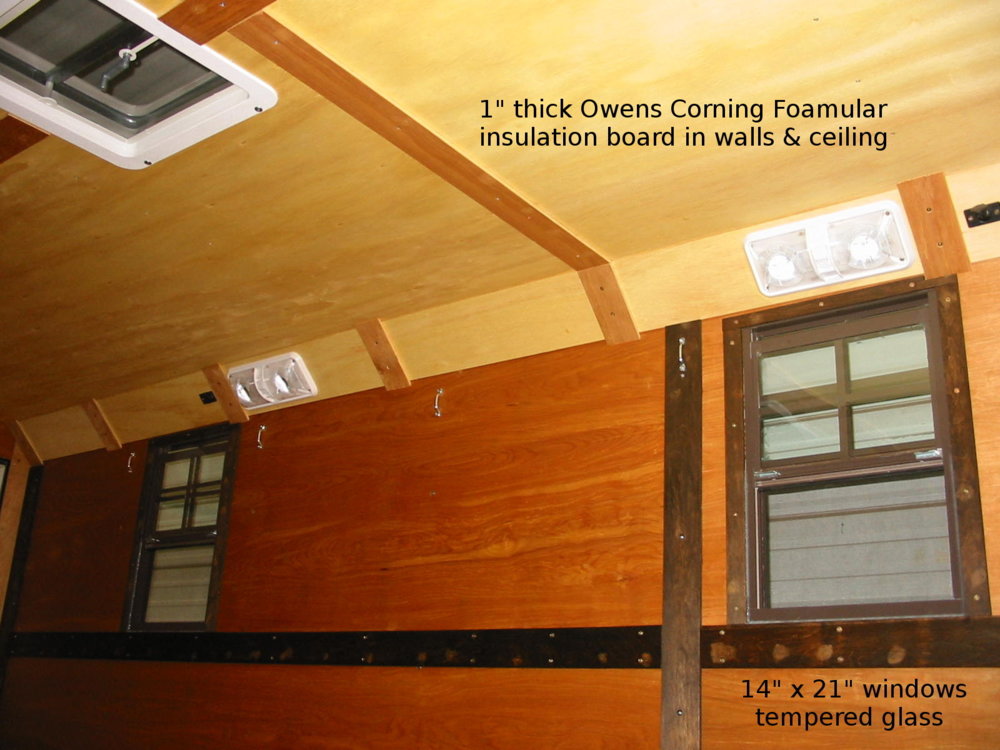

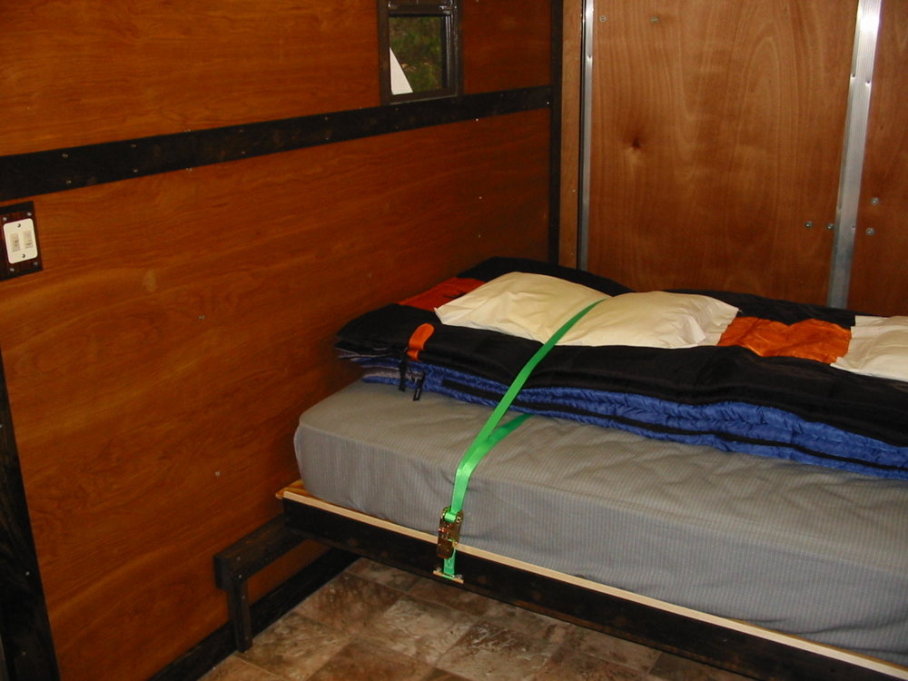

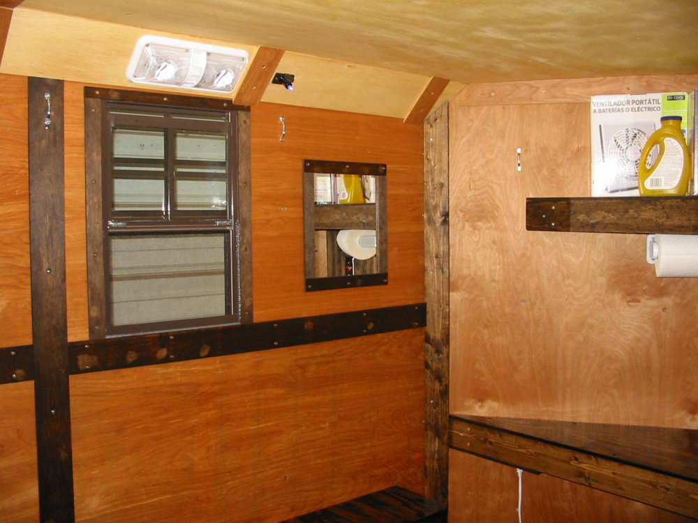

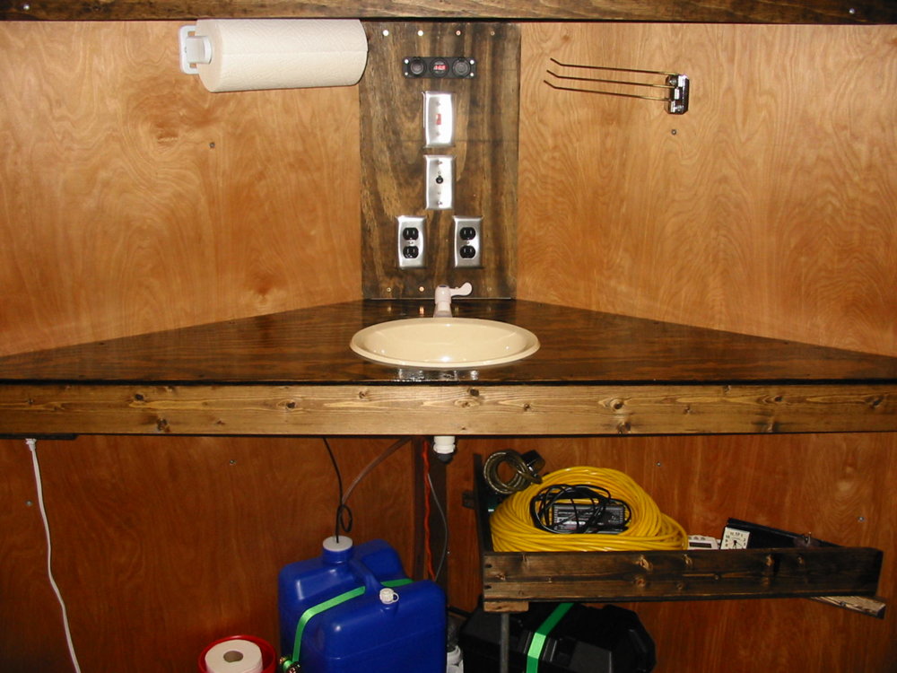

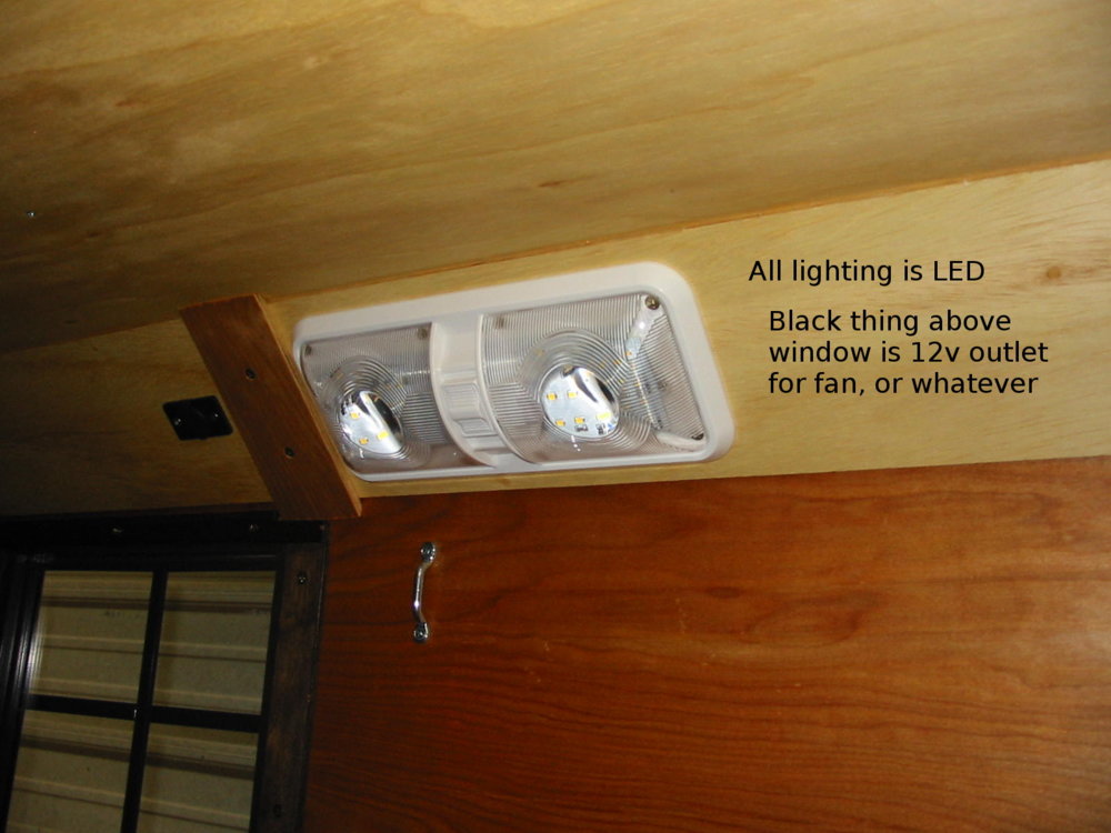

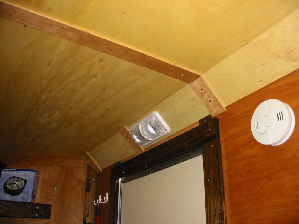

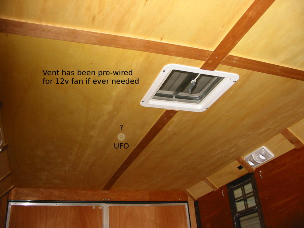

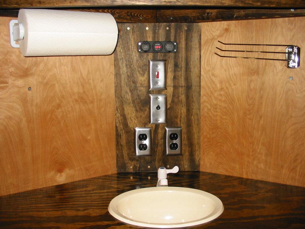

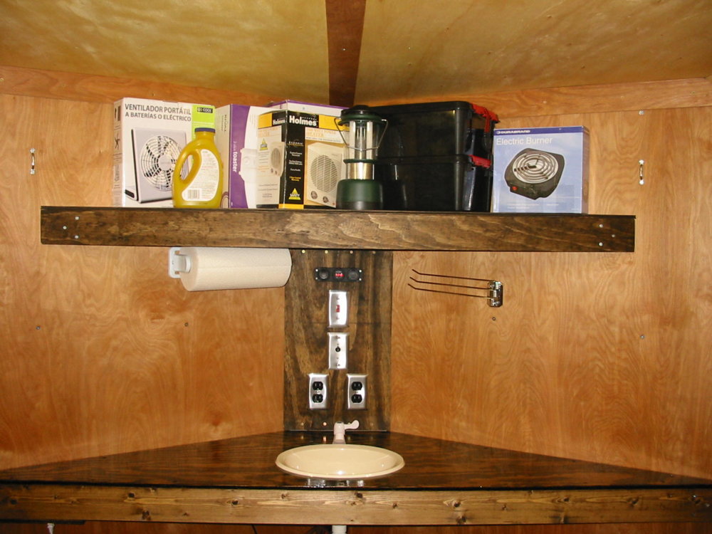

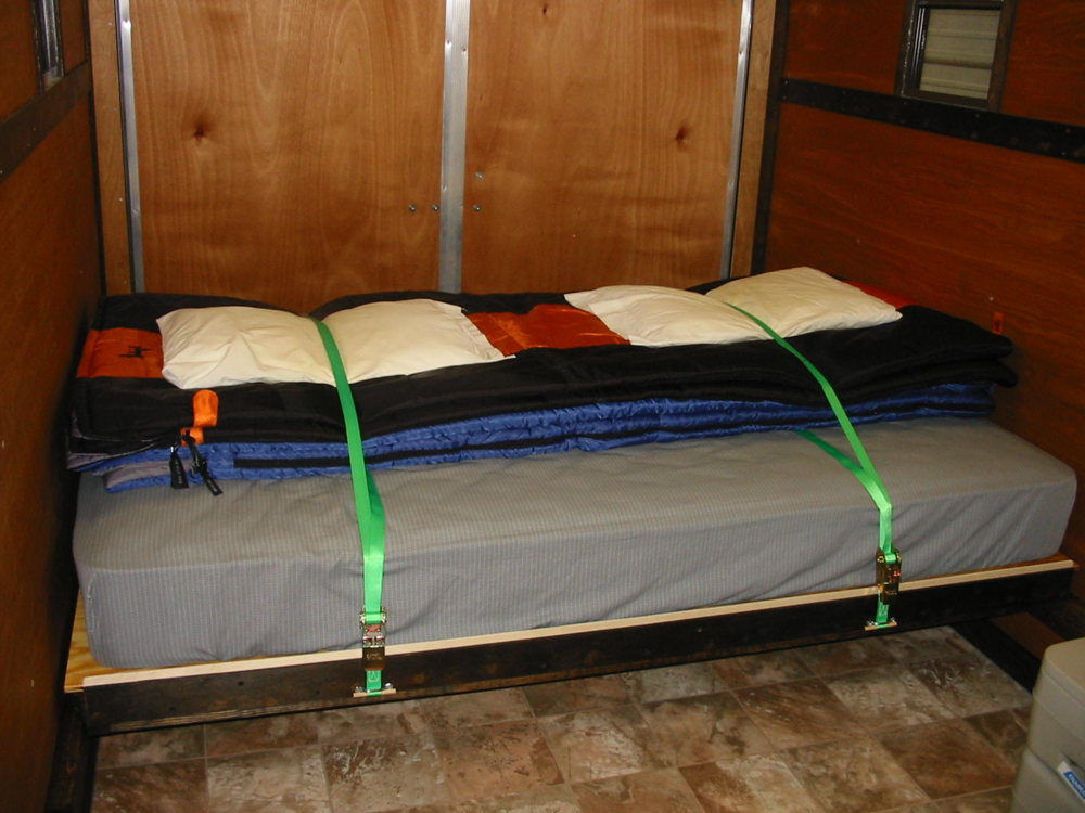

I have kept myself amused this winter, and the weather has been perfect for doing it. I sold the popup camper last May. After the sale, it didn't take very long for my wife to inform me I needed to find us something else. I looked at campers most of the summer... couldn't find anything that suited me so I decided to build one the way I wanted it. I bought a new Freedom 7'x12' (single axle & barn doors) and took delivery on October 28th. I started to work on it almost immediately and have 99.9% finished it today. I completely gutted it, added 1" foamboard insulation in walls and ceiling. I used the original paneling as it was nice. The rest is plain old pine wood with walnut stain and polyurethane coating on counter top, door frame and shelf over spare tire. The main feature is a queen size bed (which folds up). Other amenities include a small sink and toilet for night calls. It is a cozy place to sleep and was never intended to be much more. I believe we will be very happy with it. Like any other project, it probably isn't as done as I mentioned above, but time will tell.....
Thought I would share. I didn't take any pics as I went about it. Most everyone knows what a basic cargo trailer looks like. I believe the pics of the improvement will speak for themselves. :)

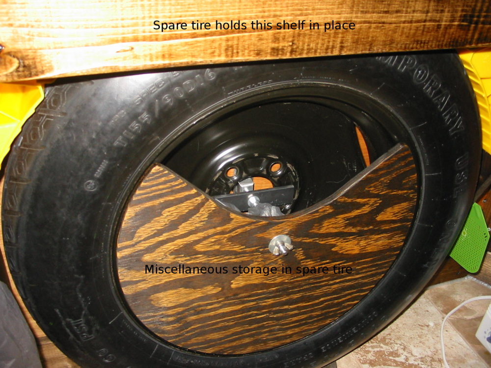

nice! That spare looks like a donut, does the standard trailer tire fit there as well?
Ha Ha... that is a donut from a Grand Cherokee! I made a makeshift caliper to measure the tires with. The donut is less than 1/16" from being the same diameter as the original tires. I also pack a plugging kit in the truck so chances are I will never need the spare... but, just in case it will get me down the road.

I failed to answer paradisePWoffrd's question... I have not tried fitting one of the trailer tires in that spot, but I believe it would go in there OK. That shelf is removable... the spare tire actually holds the shelf in place. Since the tire was already taking up the space I decided to put the shelf there thinking it might be handy for my wife to put hair dryer, etc. on as it is right beside an electrical outlet... and it looks a little better. :)
I saw that it was removable, but couldn't tell if it needed the spare to stay. Also i would hate to lose my shelf because i had a blowout.

I slept in the trailer for the first time last night. It got down down to 26° last night according to our thermometer (front porch). My little 1500w electric heater kept the inside warmed up nicely. I hung two small thermometers up in it before I went to sleep. When I first woke up this morning (6-7 am) the one in the back read 68° and it was 70° in the front end. That was even better than I had expected. :)
