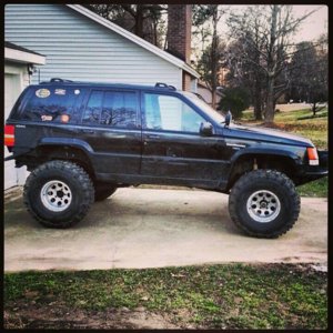

Well the updates will be slow. Still not sure on a direction but here's some parts I picked up today today to get it going. The h2's are not mine bought the set with the tires for a friend. Going tomorrow to mount the rockers on the bling bling.

How much lift u got on that thing to get those 37's under the back? Lookin good buddy! I second that...I don't think I've ever seen nate do anything slow...
That's a LOT of chopping haha. I can't wait to see how it turns out. I'm attempting to lower mine and cut more to clear my 37s as well.

4.5"+axle tube diameter increase lift 3link front and custom arms out back on full widths 65" wms axles. And lowering it 2-3 more inches when we put the coilovers on soon and cutting a lot more mainly out of the front end behind the light buckets. On 37x13 boggers, 3.5" BS wheels. Tires measure 37.75" under the weight of the jeep at 14psi

Man I can't wait till Monica will let me do this to hers, haha! Lookin good bud! Are u going to cut it straight out the back or how are u going to do the fenders?
It's a spidey Jeep, rare to see one upsdie down:D Fitting 37s is going to be interesting to see, these things have little wheel wells and sit low from the factory.
