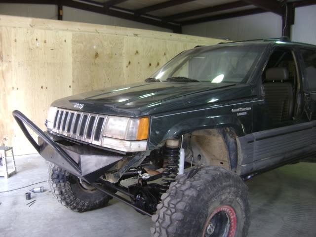

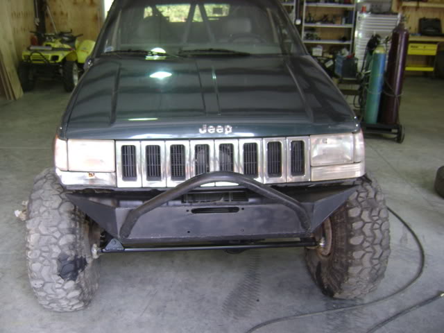

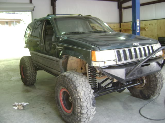

He did a great job on it! It looks great and fits even better. It weighs around 80lbs which is pretty light for a full boxed bumper I think. Its not bulky at all either, the winch mount is very well tucked up and under the bumper. Overall I am very pleased with it. And he can make a bumper for anyone so if anyone needs a sweet bumper for a great price shoot him a pm he does great work! Heres some pics of mine.

NICE! I like how its narrow enough to not take away any clearance infront of your tires. But the stinger looks a bit odd coming out from that low...maybe if it was smaller and off the top of the bumper it'd look better!
Very nice......but isn't the fairlead hole in the wrong place. Assuming the winch is mounted correctly(either foot forward or foot down), that opening is in the wrong place.......
it mounts foot forward u just turn winch over so cable rolls off top

The bumper is lite and clean. i did have problems mounting my Ramsey 8K in it from my other rig. the feet are too big and hit the top plate and wouldnt let the hole line up. i notched the top plate for the feet and it bolted up fine. My hawse fairlead does not line up with that opening. I will look at getting a diff fairlead with centered hole cause mine are offcentered about 1/2". i flipped the winch over so that the motor is on the driver side instead of pass. so that it spools the correct direction. If you want i will post or send you some pics of the things I had to change to get my Ramsey to work so you can make any changes you need to for future ones you build.
