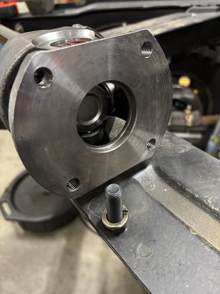

I have my new drive shaft but the flange is tapped for a different thread pitch. Could I just drill the threads out or does it need to be threaded at both the shaft side and tc side?
If it is threaded on both sides, you'll be unable to tighten the bolts.
Choose from which direction you can get to the bolts easier and drill baby drill accordingly
Thats what I was thinking, just wanted a second opinion Thanks
