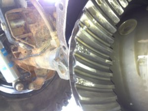

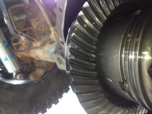

I changed the fluid after work today and it looked fine. I did add 20% Hi Tach to the ATF. It made such a difference in my NV3550 transmission shifting it was amazing no more crunch crunch when going through the gears. I took the rear diff cover off while I had it on the lift. I was suspect that my OX cable was not set up
just right. Well it is a good thing I did because I found the bolts that hold the side of the locker the part that slides to lock the axles were all finger loose if they came out a little more they would have hit the Main Bearing Cap and to top that off I found this which I will start another thread about. Thanks for your Time and sharing your experience's with the Tera Low
