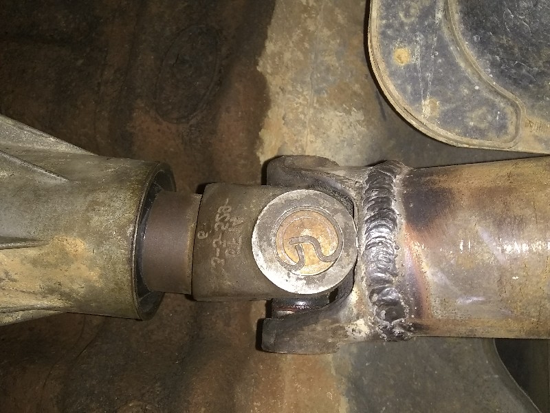

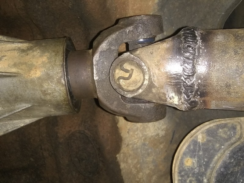

Anyone know where I could get a sye (yoke only, like a hack n tap) for the Chevy np208?
That or high angle/clearance slip yoke?
Or maybe even just an offset universal joint to get more angle out of what I've already got?
A new high clearance slip yoke would be great. I can get 23* from the one yoke binding. The other side binds at 27*. I need to get about 36*.
Converting to fixed yoke would work also.
Pics for attention.
