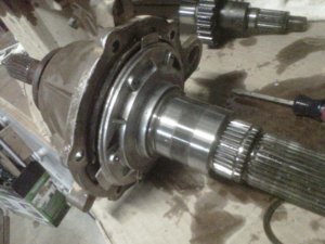

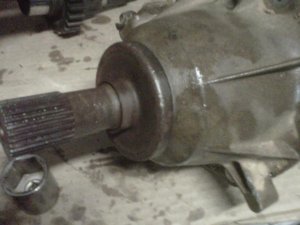

Ok so the rear tailshaft has over a 1/4" of play in and out. When I push it in and turn it I can hear a grinding noise. So I tore it apart and there are some light metal flakes in the fluid. I think the bearing has gone on the tailshaft? I don't know how to remove the tailshaft. I split the case and have the small tailshaft housing removed from the half of the case. Does the metal cover on tailshaft against the housing get pryed off?

isn't that an eyelet snapring on the shaft right in front of your pump in the pic? if so, remove that to pull off the pump and then shaft
Normally you can use a small punch or a good scew driver and work your way around it a little at a time. I might add that I have disfigured a few too in the process. Once you get the cap off I am sure you will find the issue.
