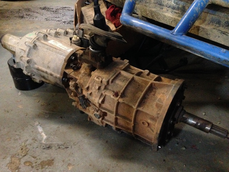

I'm looking for a 241 with a 23 spline input and the 6 pinion planetary to put behind an ax-15 in an xj. I did some research on this a while ago but am unable to find it now. I think I'm looking for a Dodge 1500 transfer case. Can any of you confirm the years and model trucks I'd find this case in the pull a part?
Picked up a 241D from the pull a part and it has a 23 spline input. It matches up to my ax-15 perfect.
