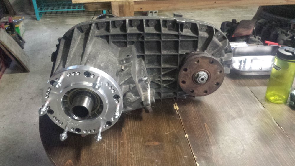

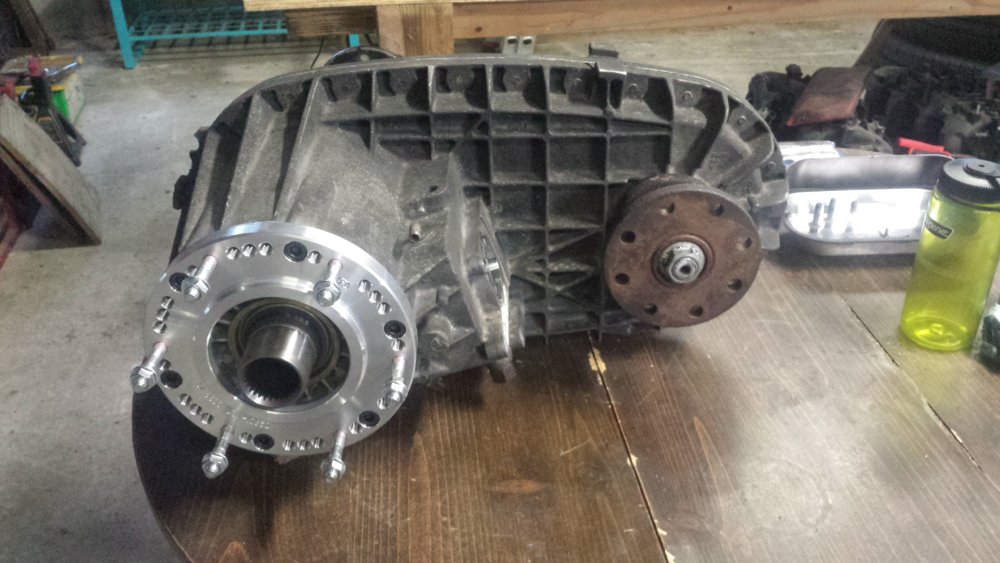

To get the transfer case at the proper angle. Without it, it would be hanging almost straight down.
Hello from Russia!
I want install to Allison transmission np273f transfer case with dodge 29 splines shaft. Please say, why you use ring flange on this place on photo?
The ring allows you to rotate the mounting orientation of the transfer case so that it aligns correctly with the truck body above and the skidplate or crossmember below.
That's pretty much what I said :D
I tried to keep it simple for translation purposes. We got him covered either way. Maybe he'll want me to build him one. It'd be cool as hell to have something I built go to mother Russia!
Wait...would I be colluding then? Ehh...I'm not running for any kind of office, so who cares? :D
