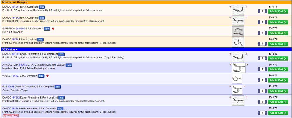

While the numbers on the data stream still look better, Check engine keeps coming back with same 0420- 0430 codes. Guess I'm still looking at the inevitable replacement of the Cats in order to properly fix this.
Looks like not too difficult of a swap. luckily someone engineered this section to bolt in and can be done in the driveway. What i'm wondering now is, what quality do I need to run with? They really range in price and I only want to do this once.

Of course my year is twice as much as all others. that doesn't make any damn sense. 2013 1500 with 5.3 is half the cost of the 2014, and they LOOK the same.

So, why not Mangaflow or a reputable performance brand? Those are in the $600 range that I found.

The 14+ GMs are VERRRYYY picky about catalytic converters in stock form. That's why @Noel said OEM only.
I did magnaflows for a customer. They failed in Florida haha of all places ironically and he had to go to a dealer. They melted and put him in limp mode. I’d go oem or delete them. Weird all my cars seem to have military level emissions 😂
