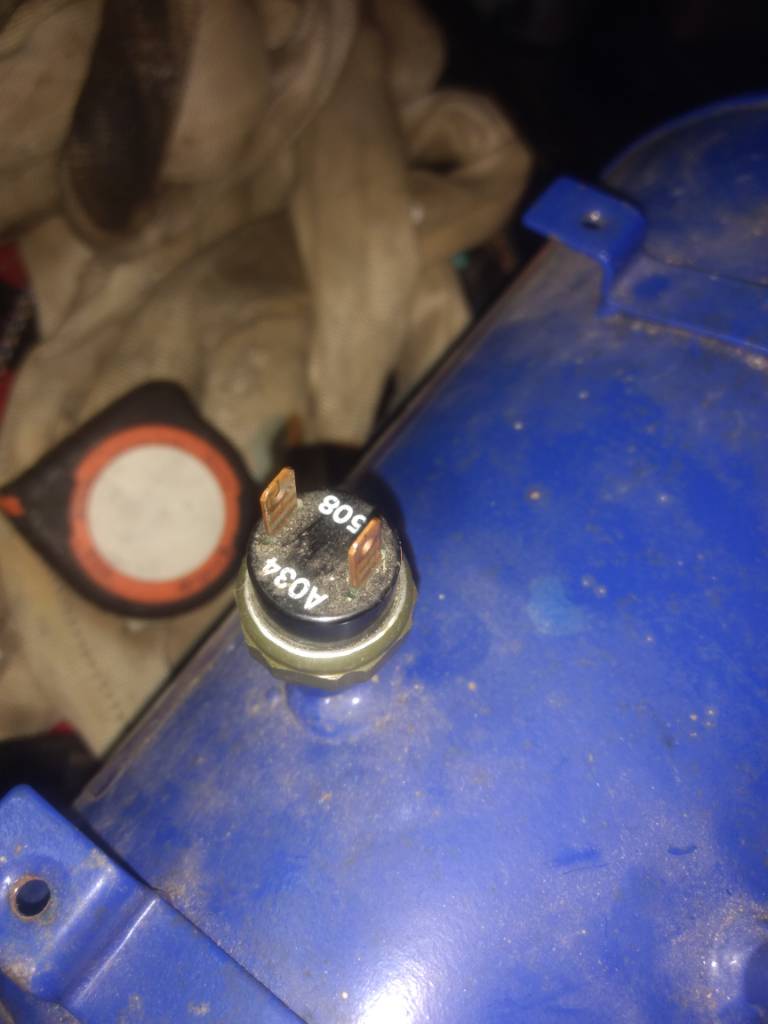

I got a free tank and pressure switch I would like to run oba on the Toyota have a question about the pressure switch it has two male terminals so do I run the 12v off my existing ac on power to one terminal then run a wire from the other terminal to the compressor

You'll run that inline with the low current side of the relay that controls the air compressor.

Mine is run inline to the hot wire from my switch to ac compressor. No relay. Its just a small electric clutch, doesnt really need one as far as I can tell.
