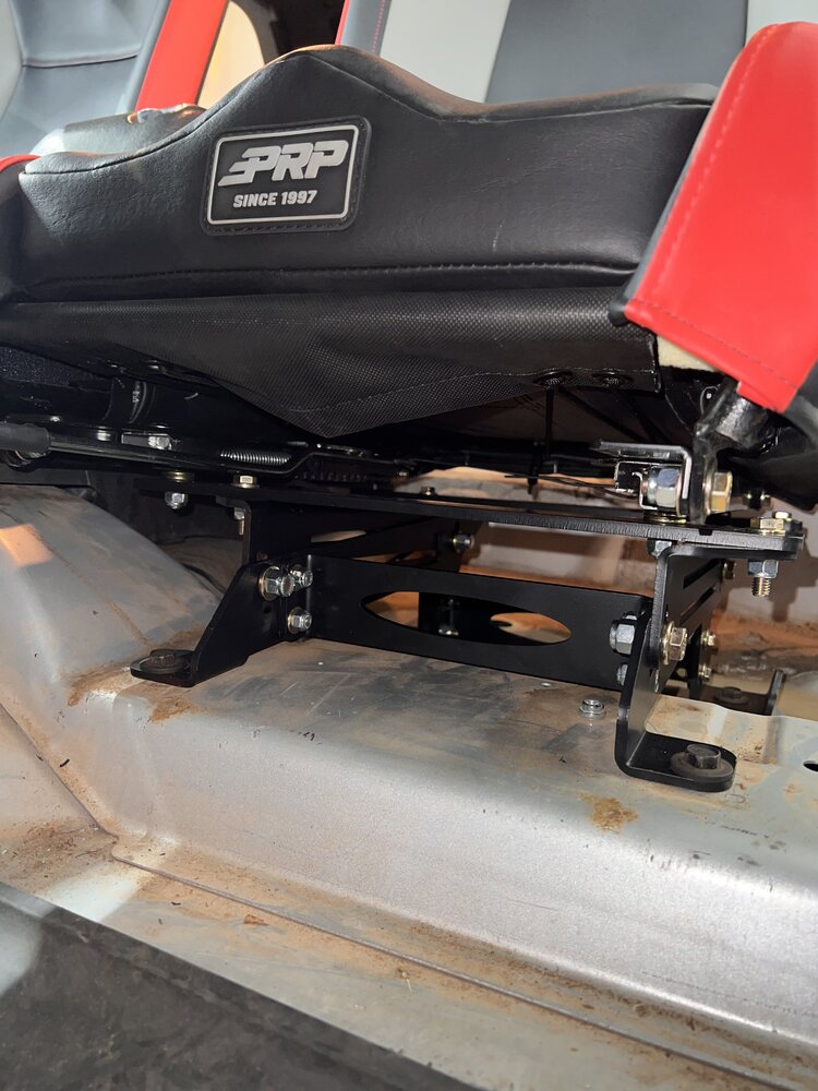

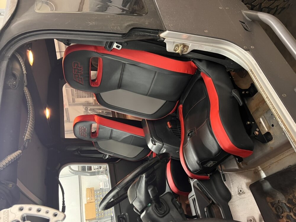

I just put PRP enduro elites in my LJ. I used the Genright seat mounts which were ridiculously expensive, but I knew the adapters to the factory sliders would be way too tall. I used universal sliders from Kartek, they bolted right to the Genright mounts. Exactly the same as the ones PRP sells, just cheaper. You lose the fold and tumble, but the enduros fold way forward. I’m 5’9” 280 and can still climb in the back pretty easily.

I just put PRP enduro elites in my LJ. I used the Genright seat mounts which were ridiculously expensive, but I knew the adapters to the factory sliders would be way too tall. I used universal sliders from Kartek, they bolted right to the Genright mounts. Exactly the same as the ones PRP sells, just cheaper. You lose the fold and tumble, but the enduros fold way forward. I’m 5’9” 280 and can still climb in the back pretty easily. View attachment 397353View attachment 397354

So far I love them. No wheeling time yet, just street miles to and from work and around town. But they very comfortable. The bottom cushion in my factory drivers seat was broke down pretty bad, so it’s much better than what I had. I need to get the seat heaters wired up. They would have been nice Thursday morning at 4:00 when it was 50* with no doors or windows. Lol
