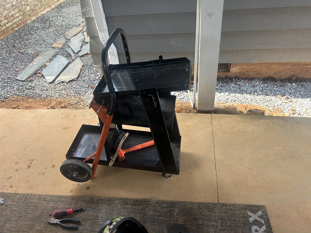

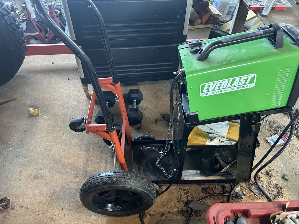

I currently have a cheap hf weld cart a dolly with bad wheel and a run flat wheelbarrow wheel that I replaced with pneumatic. Idea is to buy another run flat and the largest casters at hf so I can run my welder back and forth to my carport from the shop.
Gas bottle will be the heaviest part of it, welder is 35# with a10# spool in place

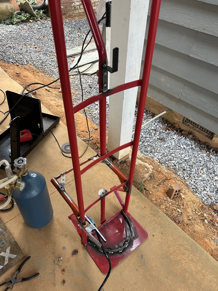

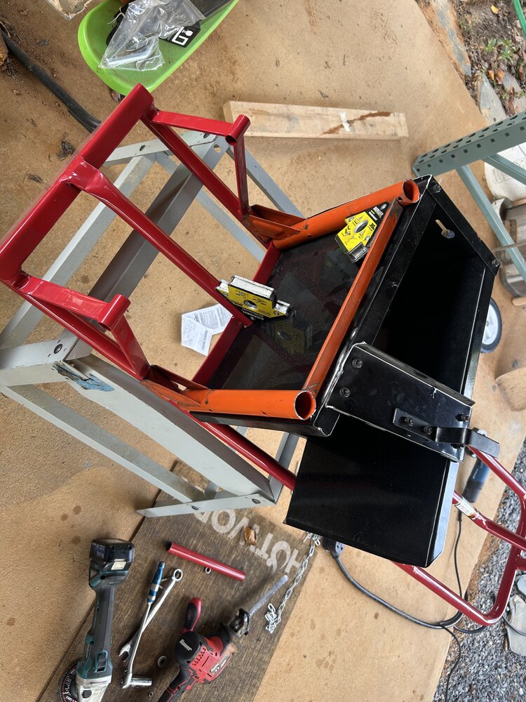

Concept photo more to come

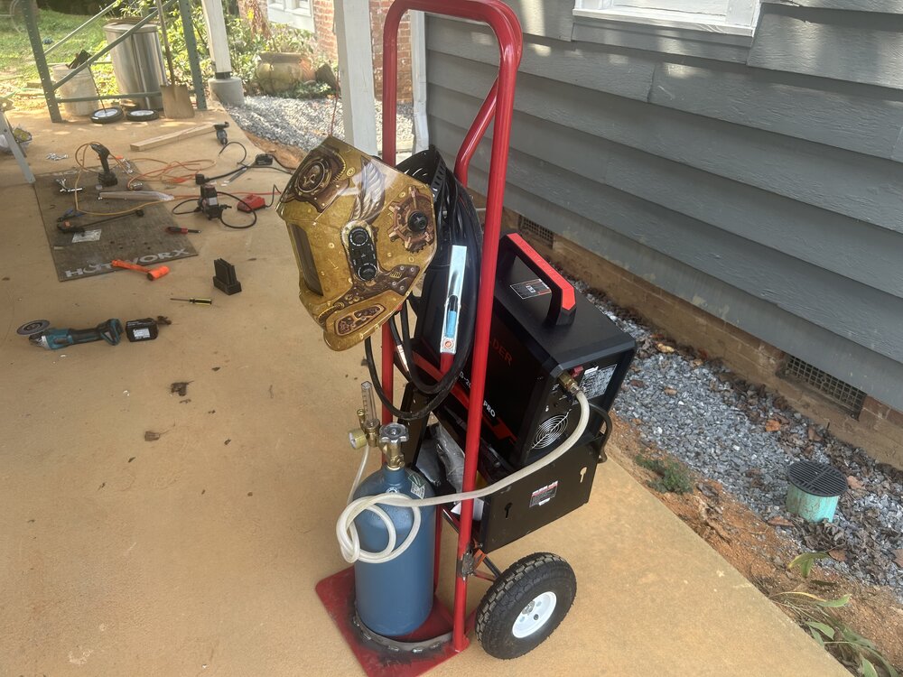

axle size was the same between the cart and hand truck, was able to cut 1/4 off the tube stick out and run the trucks axle. Got some 10” wheels from hf for $7 a piece and some 4” casters.
Net change from 5.5 to 10” rear and 2.5 to 4” front casters and a stronger handle so I can rock it back on 2 wheels
