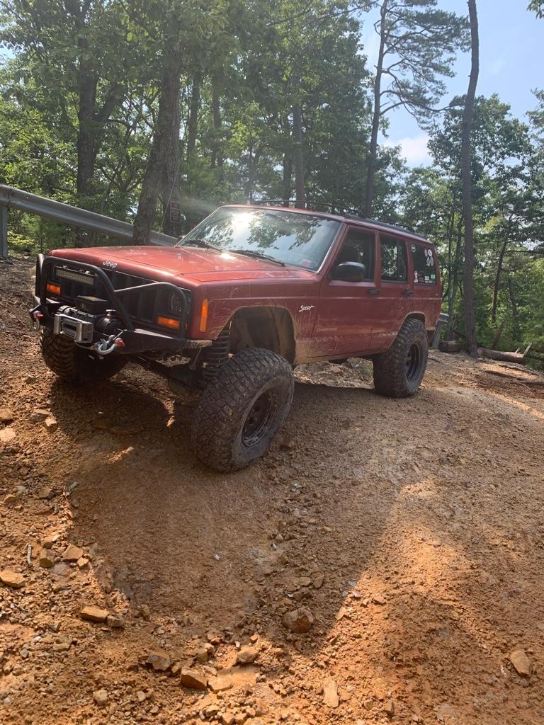

So I've been hanging out on this site for a while and have said I'll make a build thread for over a year but life. So a little back story of the jeep, I picked up a Cherokee about 7 years ago and did most of the work with in the first year during college. Went with a 4.5 in rough country lift (wish I would have saved up something better). Then I made the mission that all dumb kids make and went light bar over lockers. and got some dirt bound off-road bumpers, a light bar, and winch. then started to take it out to some local private land, and Uhwarrie A few times. had a blast and this started my theoretical plans to make it even better, but at the time I was working on my masters and was saving for a wedding. At this time the jeep radiator blew and was having trouble starting every morning, so at this time my future wife and I who where a 3 hour drive apart decided to take the jeep off the road and store it on her family's farm and I got a commuter car. Well we got married and I moved up to the rdu area with her since she had a great job here and the jeep sat I did make a fun trail around the farm to drive when we went there. Then after about 1.5 years of sitting we got a little garage add on to our apartment so I could have place to work on the jeep and store all my tools. then a year later we moved again out to apex to a home with a two car garage that has been amazing, but still the jeep was not a priority just something I could drive never so often and time to go wheeling was a no go. Well then things changed when my brother need a car and I was so ready to just drive the jeep since my commute was only a few miles. sold the car and got the jeep to be as reliable as I can with plans to really starting to get back at working at it. Then the best thing to halt my plans happened my wife was pregnant, so I had other task to get done instead of jeep things. well after my baby girls birth this March, my wife is telling me to get the jeep baby safe but also to get some of the projects done that I've been meaning to do done. First thing that needed to get done was tires since my old ones where bald.

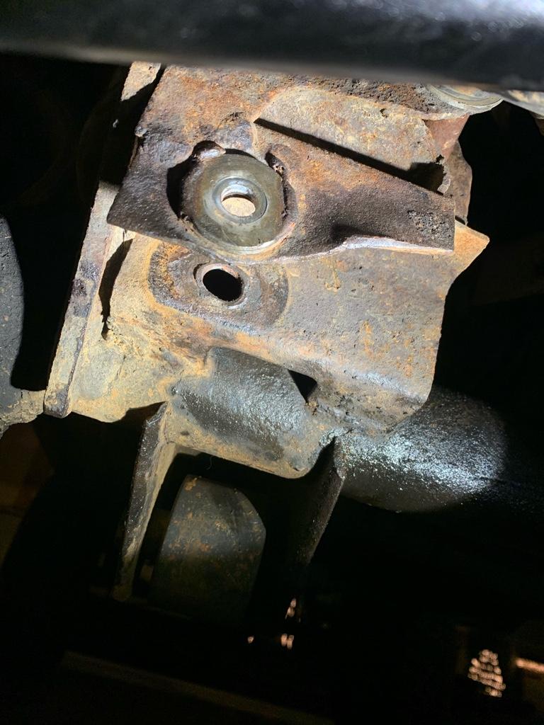

It was a great weekend to get out. Since then nothing to report just used it as my daily. But then as all Jeep’s when you think it’s all good it’s not. So starting last week I started to get death wobble on the way to work. This was an issue back before and young dum me had a shop fix it and they used washers and welded them to stop the hole from wollowing out, but never did the back and well......
The back hole on the track bar mount is oval. Now here is my question. Put the bolt back in and just try to make it till I can get a welder and try to make my own or pre made ones? Or try and drill a new hole but I don’t think there will be enough metal to the right that the bolt may sheer thou the mount then I’m out of the Jeep for a long time. My daily drive is under 10 mins all back roads but every morning it has got me.
I'd totally weld a thick washer on the other side too. Doesn't look like they got very much weld on that front one though.
More than likely, all this happened from the bolt being slightly loose OR the bracket not having a good bite/clamp on the panhard bar. Long story short, it's able to move around in the bracket and waller it out.

I think it would be difficult to get a washer behind the rear hole and weld it well/have enough room for the nut. I also don't think you could put the washer on the inside because of the width of the track bar/bushing. I'd help, but I'm in Charlotte.

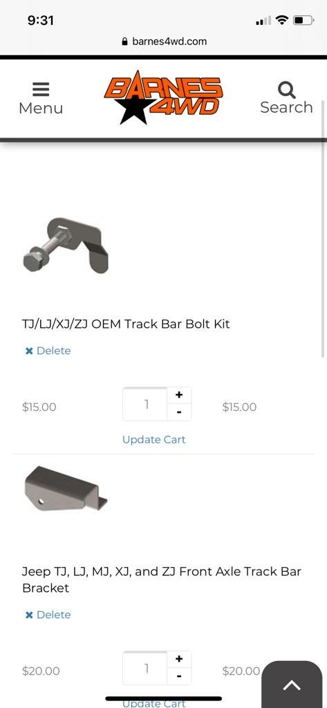

This is a good idea both off you. I will try and jerry rig it to get my by and order that and when I comes I'll post something up in the general chat to see if I can get a hand with it. Thanks :beer:

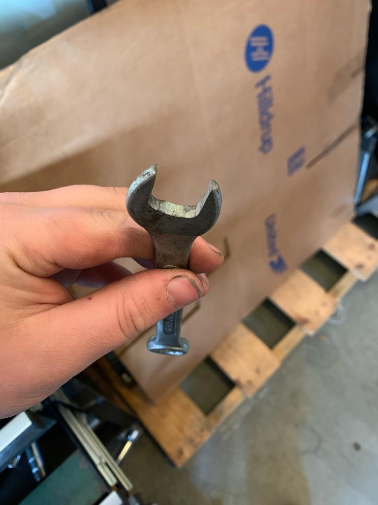

So the keep is band-Aided up I ended up using a washer and a lock washer on the back side but since I don’t have a flag nut and the 17mm didn’t fit so opened up this old 15 I had.
Now just need to wait till Christmas calms down then order all this and fix it for good.
