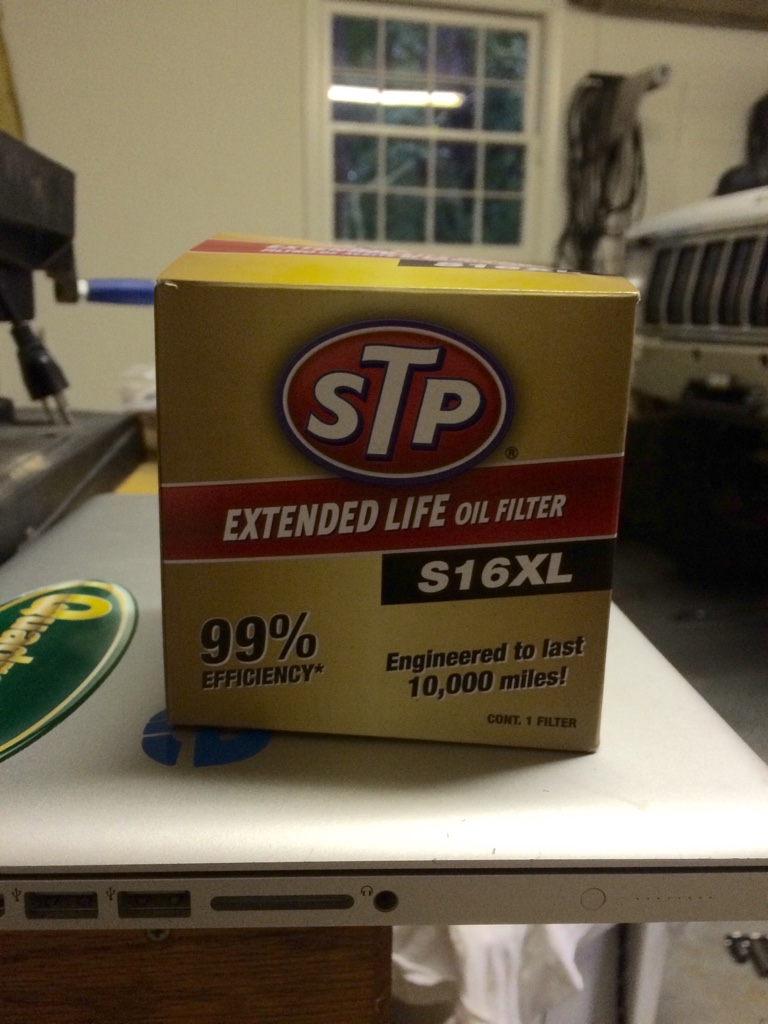

Not sure if this has really been covered. I know 4.0s will run on any oil what so ever. For those running synthetic though, what is your interval?
I am using rotella t6 with an stp "XL" filter. This jeep probably sees 10k a year. Filter claims 10,000 miles but have my doubts since it is the same size as the mopar filter I picked up from Walmart before.
Should I do a 5k interval? Or 10k and change filter half way through?
Here is the filter box.
Run a bigger filter. I ran a FL1A on my jeep. Or whatever high dollar version of the Ford fl1a you like

A bigger filter would be better, but I have a really hard time running oil over 5k miles. Sure it doesn't break down, but with a Jeep we all know how bad they are at leaking so not like it is really a closed system any more. Just peace of mind, I change all my cars at 5k.

The XP filters are supposedly a slightly higher micron rating filter media, so the same filter media surface area will flow longer without getting clogged. I'm not sure that lower filtration is a great tradeoff for longer life, and I'm not a believer in getting every last ounce of performance out of oil until it's flopping on the floor dying, so I don't use the XP filters or do crazy long intervals.

Great info guys. I came across a wix filter that is the larger ford filter. Wix 51515 I will look for the FL-1A or wix next time I am out :)
The 51515 is the cross ref to FL-1A, either should work great. The FL-1A is apparently made by Purolator for Motorcraft, and is highly regarded.
The Wix 51515 is the NAPA Gold 1515, if you have a local NAPA.
