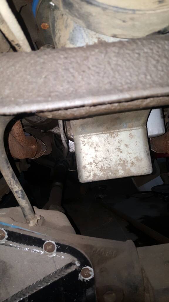

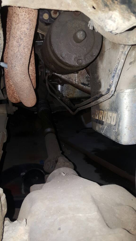

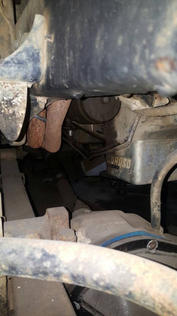

If you get a circle track pan, make sure you will still have room for the front driveshaft.
Thanks guys I am going to go with a 7qt pan, Now I just have to figure out which one will not hit the front drive shaft.
What kind of front axle do you have and any lift?
I'll send a picture of a 60 with 4" of lift when I get to the shop today
