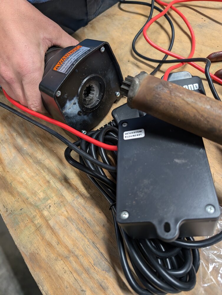

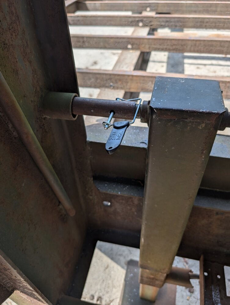

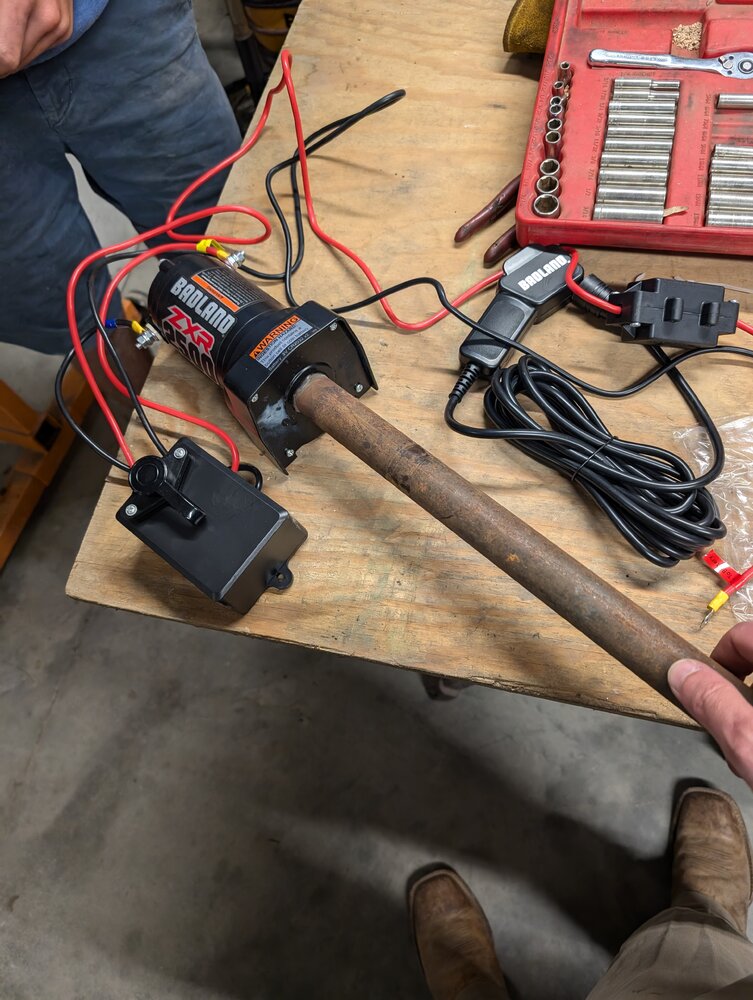

Hobo freight 2500 pound winch conversion to jack motor.
Pulled the spool off and welded the splined piece into a bushing and piece of tube. This will slide over the passenger side of the trailer's jack handle rod.
I'll put a hitch pin in it so when the winch takes a dump I can pull the pin and put the manual handle back on.

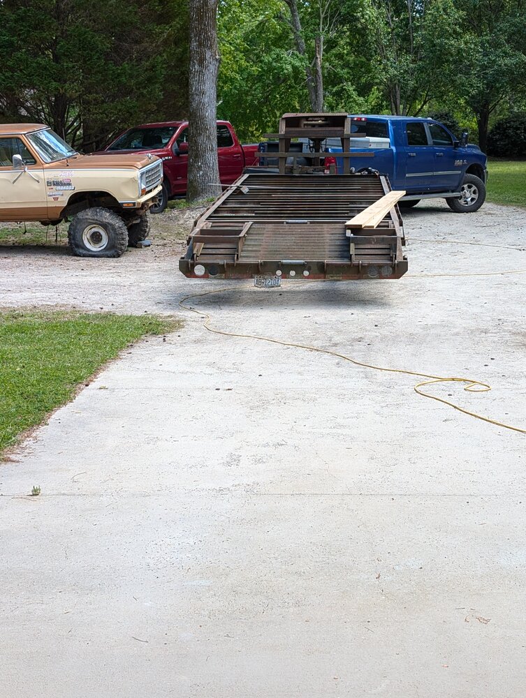

Bare trailer, welded in another cross member because I couldn't get 24' long boards so I'll seem it at 12'. Also welded in a 12" Chuck of I-beam at the neck to move the winch higher and off the deck (seems to be a target for anyone loading or unloading with a grapple)

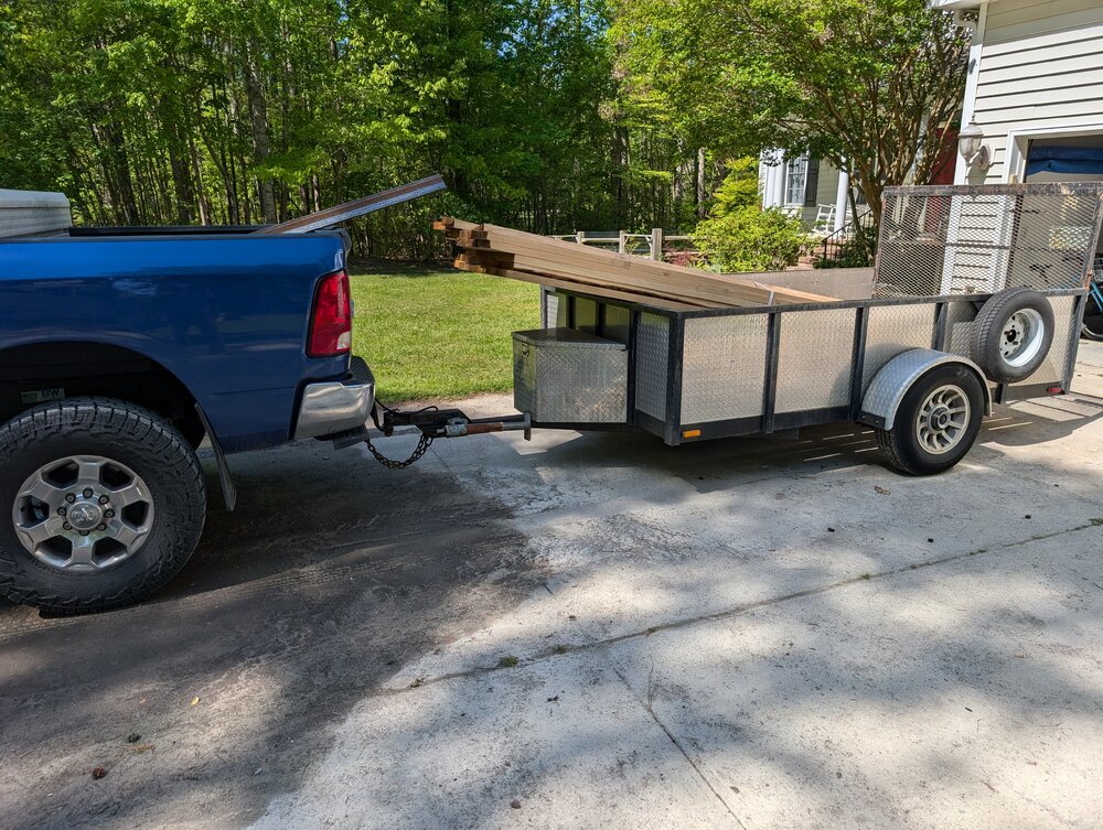

Picked up the white oak from the mill. This is the legit way to buy lumber unless you have your own mill. Got 27 boards 8" wide x 1-1/2" thick and 13' long for $400.

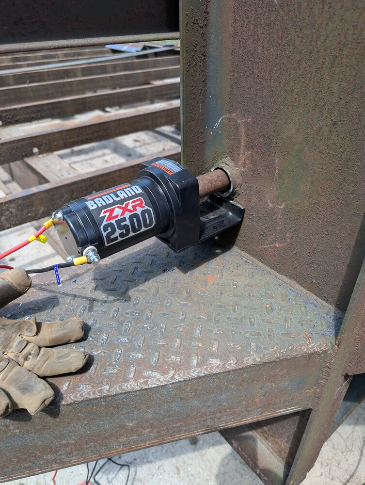

Jack motor mocked up
Release pin for jack motor

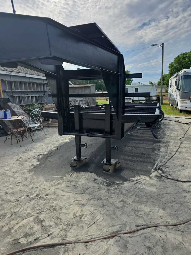

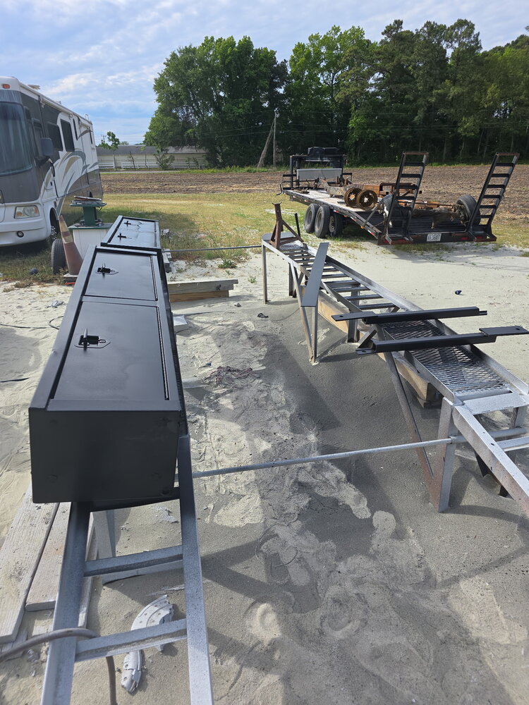

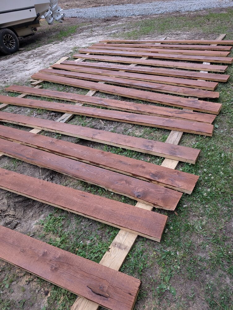

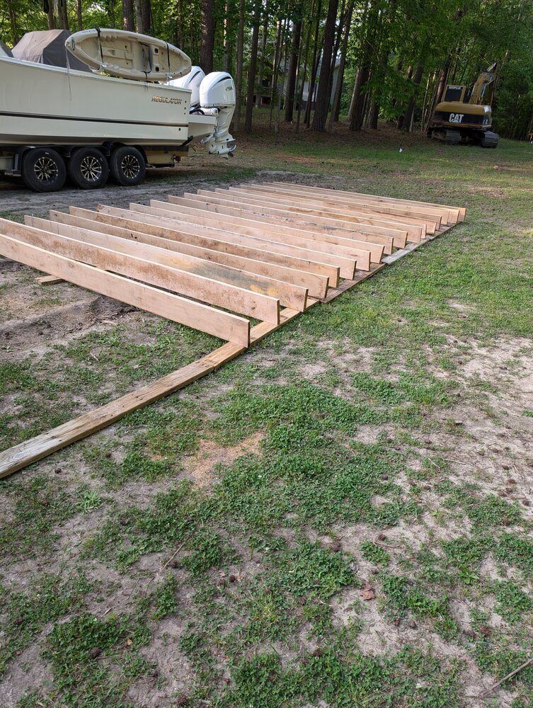

Dropped the trailer off to get blasted and painted Monday night. Set the boards out to dry before staining and sealing.
Hoping to get the wagon back by end of week so I can put it back together this weekend.
This is about half of them...

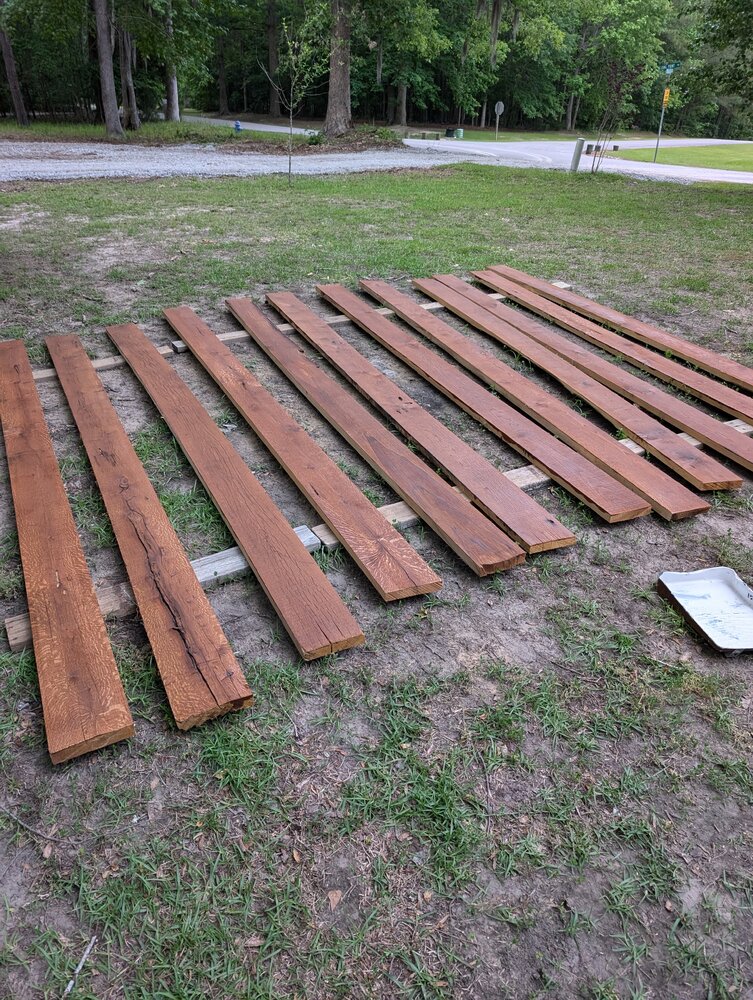

Oiled boards today with the Apitong wood stain / oil / sealer stuff. Went about half as far as advertised so I only got the top sides done, barely. Not sure what I'm going to do on the bottom. Maybe nothing, maybe used diesel oil? Don't want to wait on more of the Apitong stuff to show up. Maybe I'll order some and install these coated side down and do the tops after assembly.

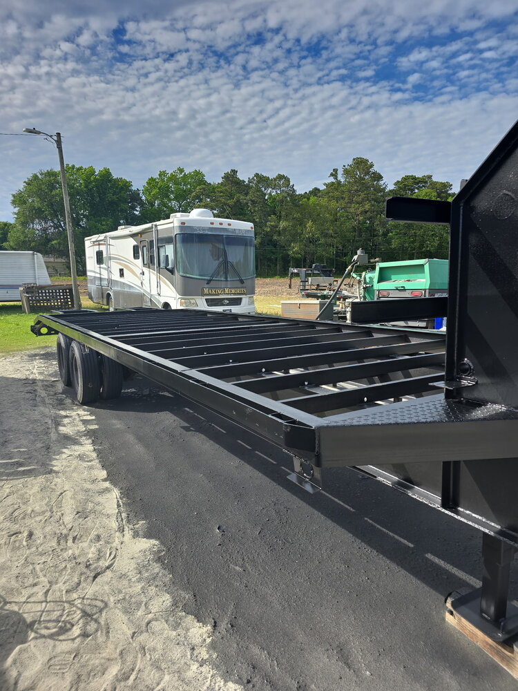

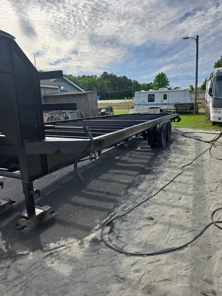

Picking up the trailer tomorrow from blasting and painting. Pics of trailer from my blaster dude
Hoping to get it back together this weekend.
Dangggg! That looks way better than it ever has! Be careful, folks might think you're getting fancy :D
I would seal one side and the edges and reinstall. Then paint the top after installing them.

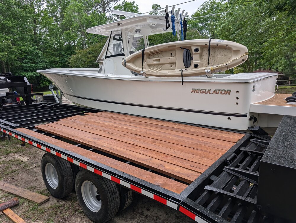

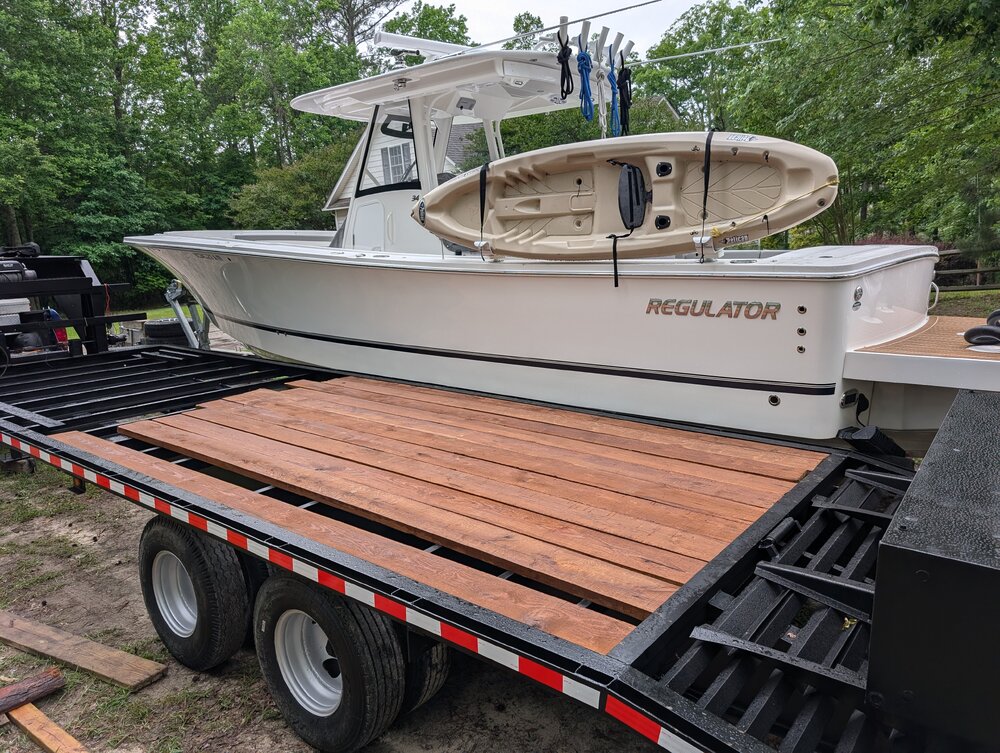

I only got as far as all dot lights, harness, and battery. Haven't acquired switches yet or done the harness for those, but I did toss some boards on it last night (not attached or trimmed yet) but I needed to park it back in it's spot for the week, which was also my board staining area.
Deck stain is more orange than I would like but hopefully it holds up well. Maybe able to make more progress during the week...

Deck stain is more orange than I would like but hopefully it holds up well. Maybe able to make more progress during the week...View attachment 438067
Man, it REALLY looks like that boat is magically balanced on the edge of your deckover trailer.
Spooled up the gyro stabilizer for ultimate levitation imagery
I was always told to oil / stain the bottom and sides of each board heavily prior to installation. Then install with the unsealed side up - once they’ve been sitting (and drying internally) for several months, seal the top side with a couple heavy coats.
