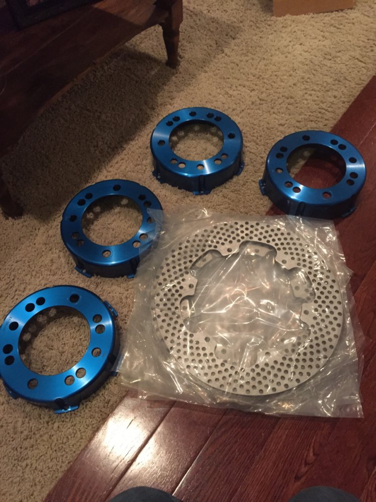

Spidertrax brakes

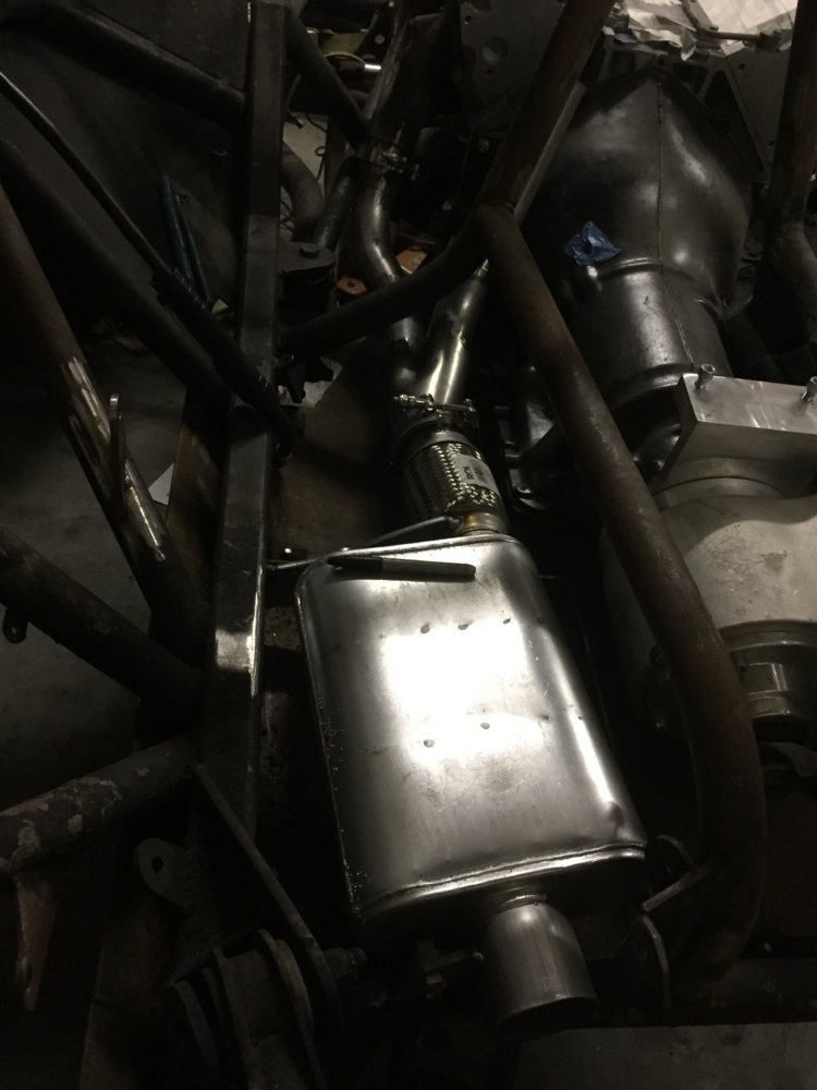

Exhaust that @Ron or @1983Bronco wont burn their ass on!
Dual 2.25" pipes into a single 3" muffler under set the driver seat. Just need to weld it out and do the tail pipe. Waiting on a 3" V band clamp that I forgot to order, then can finish up the tail pipe. :) Haven't decided if I'm running it out the driver side just behind the seat or if I'm running it all the way out the back.

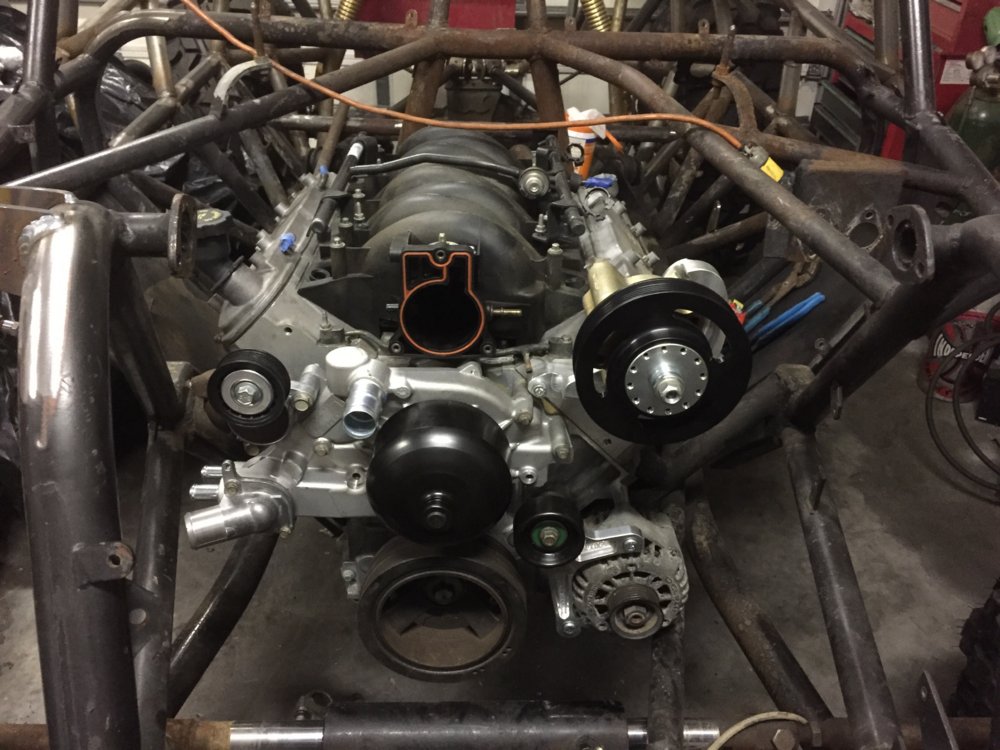

Been spending some good time in the garage in the evenings getting the LS1 and accessories put together.

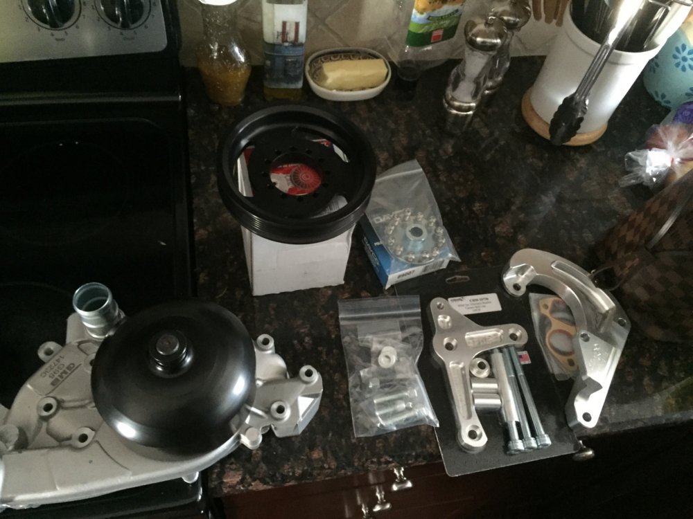

New alternator bracket installed from CBM

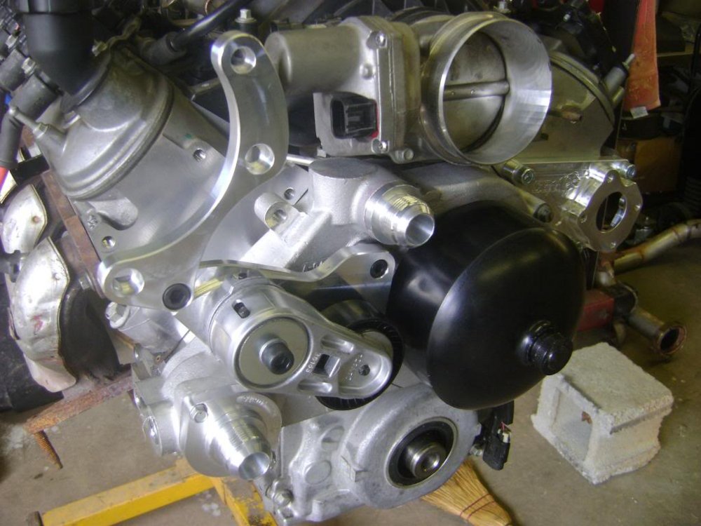

New power steering pump installed from CBM. It's the trophy truck/Lee pump so there are limited options on mounting it. Aside from fabricating a bracket myself, I haven't found any other bracket on the market. I don't really like how the pump is mounted with the suction so low but we'll give it a go and see what happens.

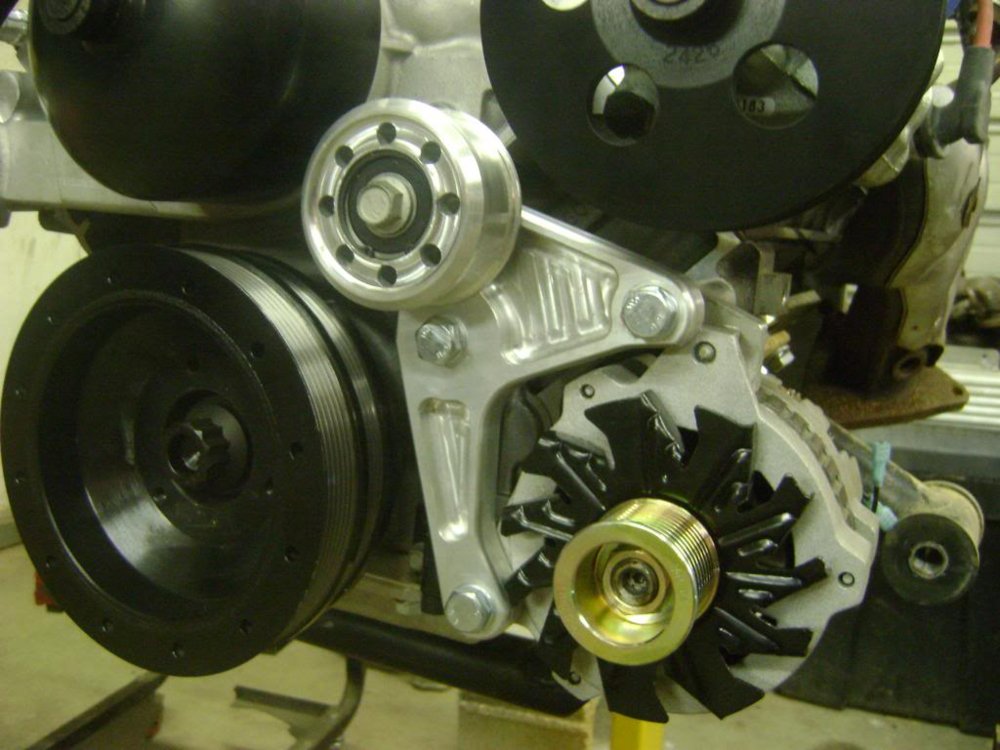

I like the cbm mount, tried to use it on mine but it was in the way of my upper link. Ended up using the bomber fab bracket on the passenger side head, still use the cbm bracket simply as an idler to get more wrap on the crank and steering pump which is mounted in front of drivers head.
Here you can see the pump above the alternator and imagine how it operates just as an idler giving more wrap on crank and pump pulleys.
That's the bomber bracket. I did do some modifying to fit my power welder alternator. Here you can also see the cbm pump bracket on the drivers head.
Also had to flip my throttle body, the dbw servo was in the way with the bomber unit.
Be sure to locktite all these fasteners, all mine worked loose in a few rides, almost caused some catastrophe.

I almost bought the bomber kit but realized my engine is offset to the pass side by about 4" and didn't have room. Ideally it would have been nice to find a bracket for the TT/Lee pump that mounted it down low in the driver side and the alternator just above it. I just don'tike the alternator down low like CBM does. I haven't found any brackets for the TT pump other than the CBM one and they only have 1 option. Ugh.
Matt, what pump are you using?
That's the same location as my TT/Lee pump but the CBM bracket looks different.
What tensioner pulley is in the pic?
What thermostat housing did you use? Looks like it comes straight out versus the side like the stock ones do.
