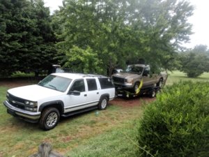

It started knocking, and I thought was a cracked flexplate, with a bad back I wasn't working on it in TN, so I sold the Yukon, bought the F250 (which will be fore sale shortly if you are interested), and towed it home, and took it to the shop. When they drained the oil the #4 rod bearing poured out. That is the second engine that truck has had in a year, I am done with it.

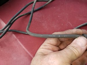

When we pulled off the wires I was greeted with something I have not seen since the 90s. Packard spark plug wires.

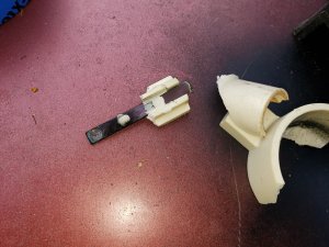

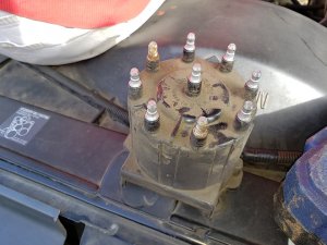

Then Steph handed me the distributor cap. I think I found the miss.
The rotor needed a bit of percussive maintenance to remove it.

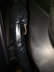

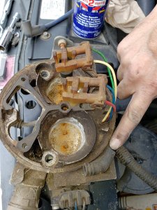

When I attempted to set the timing I looked under the dash to disconnect the timing wire. I found this.
Tells me it has never been touched. Still wrapped in factory tape.

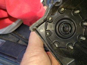

This morning, Heath and I went to the scrap yard. On the way back the dash nearly fell out of #7. These GMT400 trucks had a major flaw in the dash design. There are two 10mm bolts that hold the bottom of the dash up. And there are three small screws that hold the top. The three small screws go into steel, the dash is plastic, the mounts break, especially if you do much driving on rough roads ( or non existent roads).
You can buy premade clips to repair it, but I am cheap.

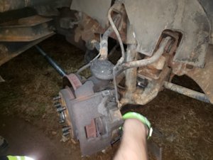

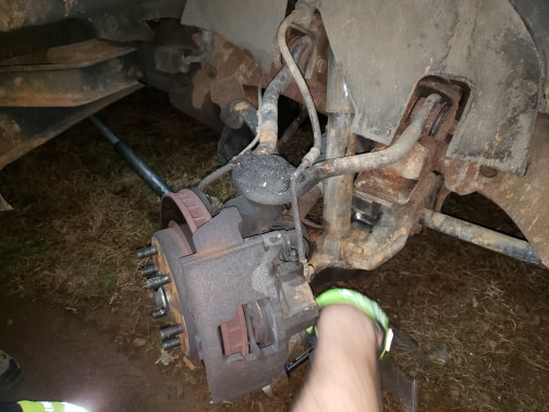

Yesterday morning we headed down to the scrap yard. I had a full day booked and no time for nonsense. Of course, the truck had other plans. The drivers front brake started grinding. It was just going to have to grind. I had brand new rotors on the parts truck so I could replace them when I got home.
200 miles later I got home and found a glitter factory.
The pads on the parts truck were a bit thin, but everything was closed so they got put on. I ordered a set of ceramic pads since this truck tows every day.
