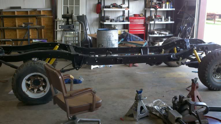

Todays progress...
rear springs hung
front shackles and new bumpstops all around
T-case x-member reassembled w new bushings
Frame front from Driver side

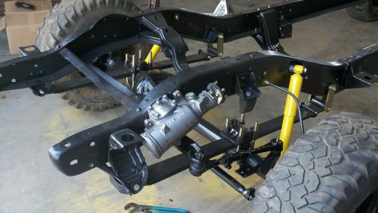

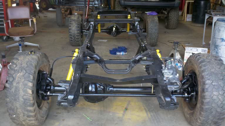

Continued cleaning on the dana 44
Both axles have been completely stripped down, cleaned, and all new bearings, seals, ball joints, u-joints, wheel studs, brakes, ect. have been installed.
The paint being used is SEM Rust Shield chassis paint which uses its own hardener. Its supposed to be super tough stuff, and lays down much nicer than POR 15 IMO.

The rolling chassis all finished up...gotta hurry and finish the wheels up and find a set of tires so these horrible roll-a-rounds can go!
