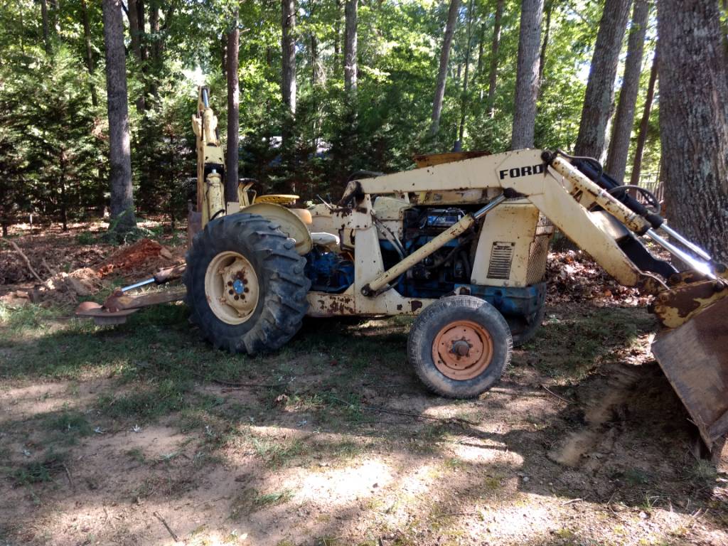

So I have this old turd is my dad's and am using it a little. It starts and runs pretty good, but after it gets hot it slowly dies. You can isn't the throttle back and it will stay running longer, but if you keep it idled up, it cuts off. When you let it sit and cool down, it will start back up. What are some things to look for? It's a 69 model, gas engine. I was guessing the old voltage regulator, but don't know how to check.
Sent from my XT1635-01 using Tapatalk
Check the fuel filter. If it has a porous brass filter in a glass bowl try it with out it.
Pulled the glass bowl last night. It was full of crud. Looked to have a brass tube in there. Not sure if it was a filter or not. I may have a chance to check it out again this afternoon. Thanks guys
