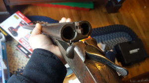

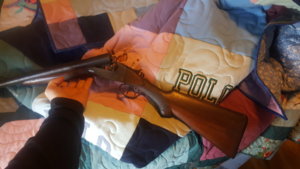

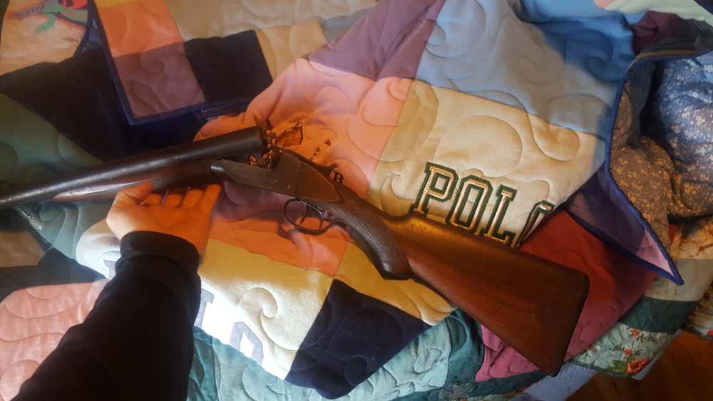

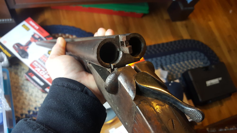

Today my uncle gave me a shotgun that belonged to his uncle. According to the serial number the gun was built by Ithaca in 1920. Can anyone tell me if it is safe to shoot with modern ammunition?

With a standard load you will be fine. Don't go grabbing any 'magnum' shells or anything. I have an Ithica Model 37 Featherlight 16 gauge from the 1930s, and it shoots great.
Companies still make light recoil and/or low pressure shells that will be fine in that, if you're too worried about shooting a modern low-brass load.
I'd get it inspected if you're not sure about when it was last used, or have any concerns about barrel condition.
I'd shoot low brass through it all day long. I have a 1890 something single shot Remington 16ga that my great-great grandfather bought at an estate sale in the 20s. Its our families go to turkey shoot gun. As long as it isn't Damascus steel (I'm 99.999% sure it isn't) you should be good to go with modern low brass loads.

Just keep with lead shot, 2 3/4” and you will likely be ok.

Your probably okay to shoot low brass. But I would shot low pressure or low recoil for the peace of mind. I saw a post on a gun dog page where an older side by side blew out.

Actually, if you look at the barrel thickness at the breech ..... I would bet that is twice as thick as anything made now.
I wouldn't be too afraid to shoot regular off the shelf stuff thru it.
Regular target loads or small game stuuf would be fine IMHO.

Thank you for the responses. I have no intention of getting rid of the gun even if it is proven unsafe to fire. I plan to let a gunsmith measure the chambers as some info I found on Ithica forums indicate the chambers are likely 2 1/2" or 2 9/16" which would be unsafe for modern 2 3/4" shells.

You can find a gun Smith to increase the chamber length, or you can find smaller shells but most will be low recoil/low pressure
