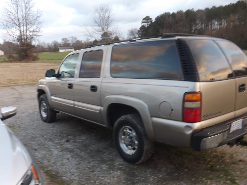

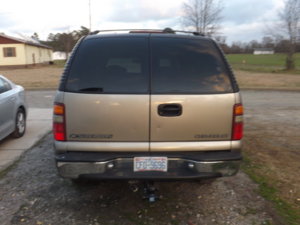

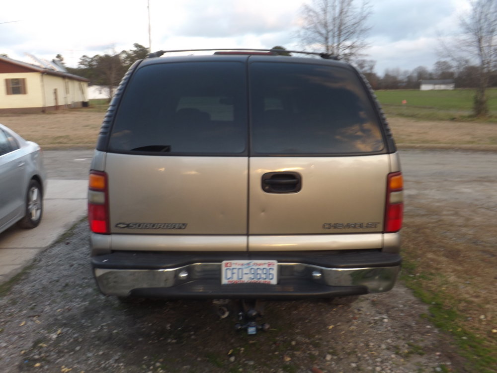

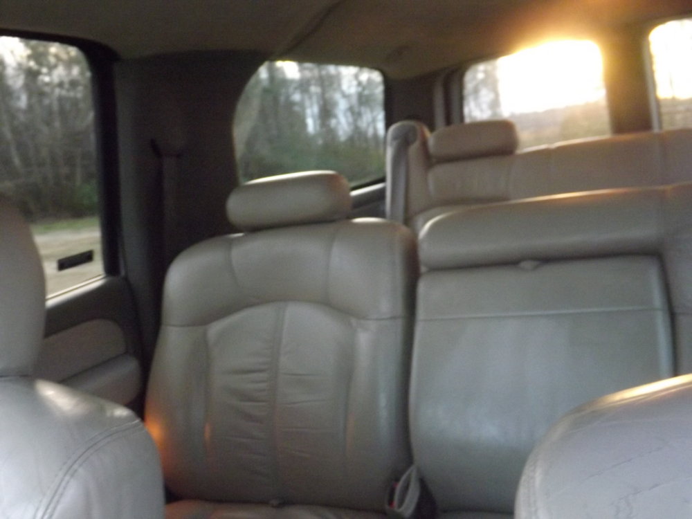

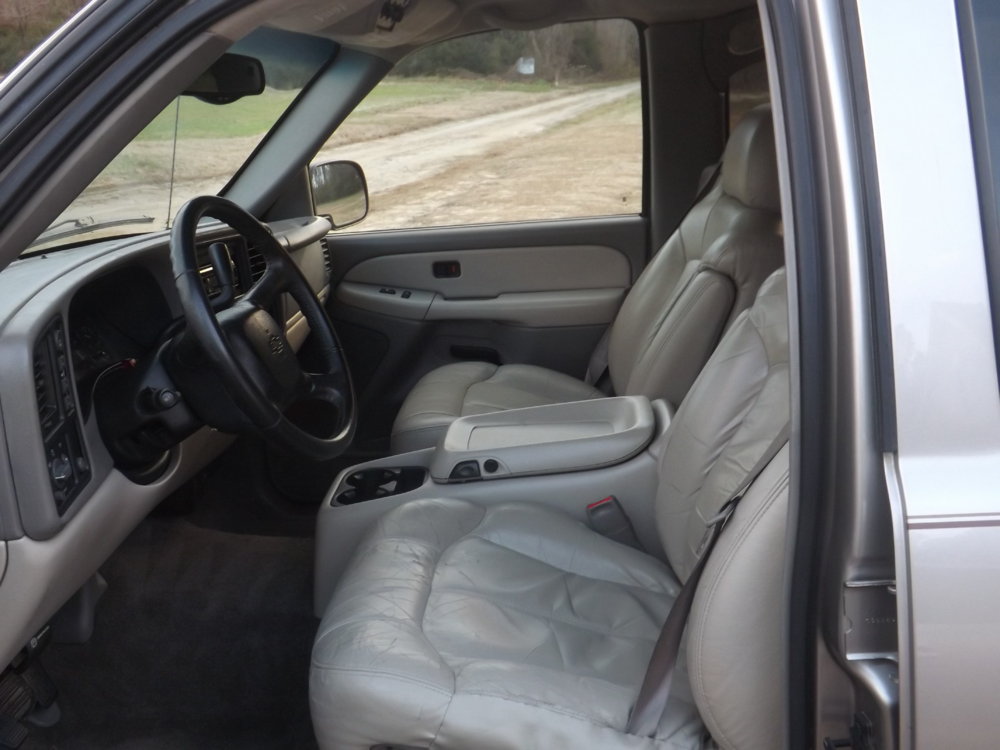

ok so i just picked up this 2000 chevy suburban 2500 and was wondering whats the bigest tire i can run with out a lift and what are some good upgrades to do to it?
