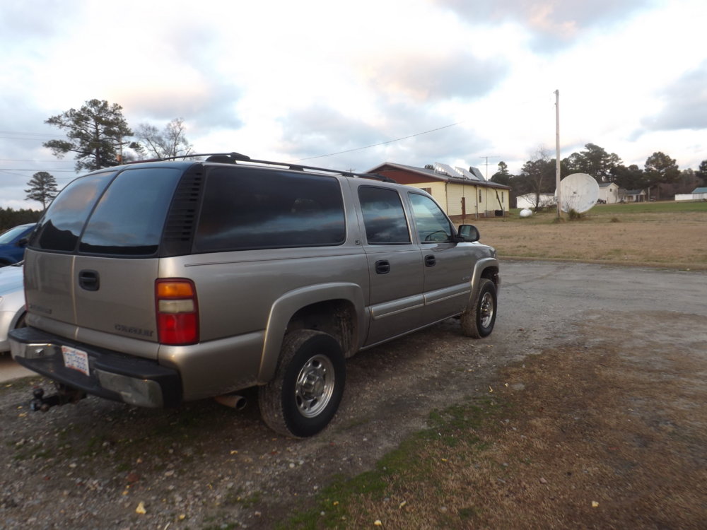

what is the best size lift for a chevy 2500 suburban and what size rims i was thnking 17" rockstar rims or 18" moto metal mo962 rims it is completely stock right now

If you are going to tow, be careful going to 18" wheels. Load range E 18" tires get expensive. Stick with the stock 16's or 17's.
U can run 285's with turning the torsion bars and trimming the front bumper support and bending the inner fender support at the bottom of the firewall back a little.
Also, depending on what gears are in it, it will only tow worse with any bigger tires than 245 or 265.
As far as lifts rough country has lifetime warranty on their lifts including the shocks. I have had great success with their products and customer service.
ok thanks might just have to go to 265 for now and lift it later on. what do you have to do to level it out do i need to buy a leveling kit?
You can get it close to level with just turning the torsion bars up.
A leveling kit usually comes with new torsion keys that do the same thing, but allow you to crank the bars even farther, as well as shock extenders.
Be careful of turning the bars too much as it will ride terrible and eventually over travel the bars.
As well, you MUST get an alignment after turning the bars as the camber will be off slightly and the toe in will be off an inch.
