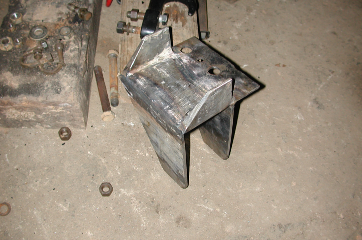

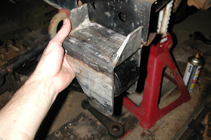

I have the PSC one. You could fab one up similar.
i stayed shackle forward and made my brackets out of 4x4x0.25 angle with gussets.
Thanks for the pics. This gives me some ideas. How much wider than stock are ya'lls axles?

I am building one that looks like the psc kit. How far are the holes in the front mounts spaced down from the frame. Trying to get an idea of how big they need to be.
depends on how much lift you want, or don't want to gain, or need.
Trying to keep castor about right. That is my main concern. I figured about
6-7" drop from the frame would be about right.??
Yeah thats what it looks like on noahs cj7. Sorry to hijack fellas!
