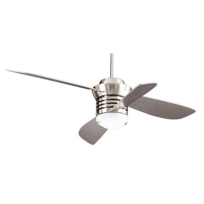

These are a little pricey, but move some air and are a cool conversation piece.
The Big Ass Fan residential model is called Haiku. Very pretty and very expensive. You can buy five Hunter fans for what one Haiku costs.
There's a reason Big Ass Fans has all kinds of money to spend on ads and giving swag to designers.
