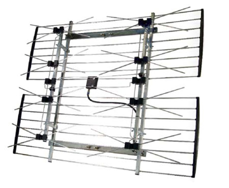

It's a channelmaster...iirc, it's a 4228... flat grid antenna, about 24"x36". I have it mounted in the attic. Never had to put it on a rotator. Most of our stations are more or less North of here, and a few more or less due South...this antenna has pretty good back plane reception, not as good as forward, but it works great here for me, without rotation.
BTW, got the antenna for free from WRAL. They are/were running a program where if you bought a new HDTV, there was a form to fill out on their website to get a free antenna. Model you received was whatever was most appropriate for your distance to the WRAL transmitter tower. I got the antenna and a preamp. Friend that lives about 5 miles closer to the antenna farm got the the same antenna, but no preamp.

edit #2, my antenna looks like this:
you can go to www.antennaweb.org and enter your address (or close to it to stay off junkmail lists). All you have to put in is a street address and zip code, ignore the rest. It will give you a listing of the stations you should receive in your area, plus direction and distance to their transmitter towers.
