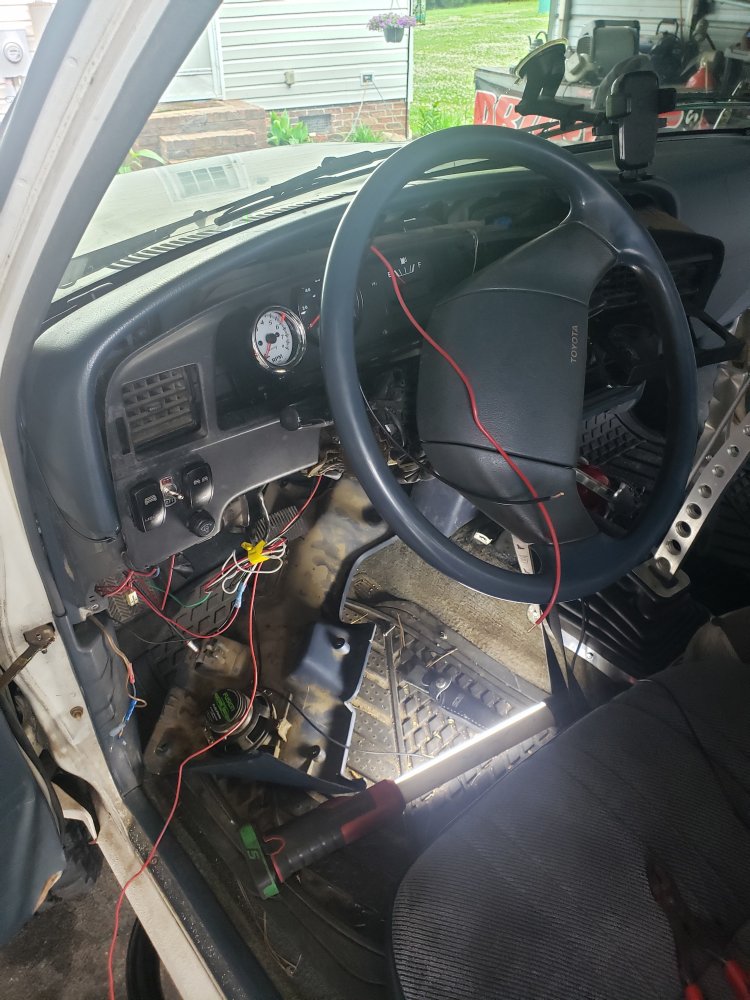

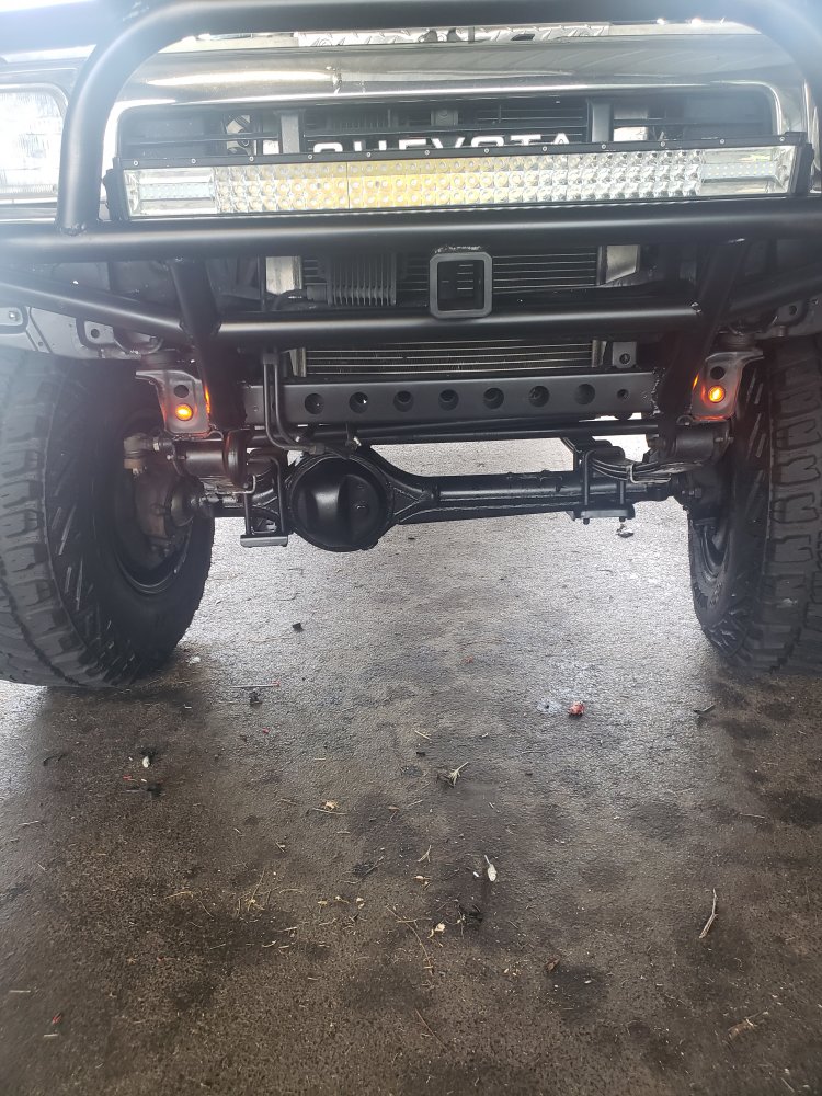

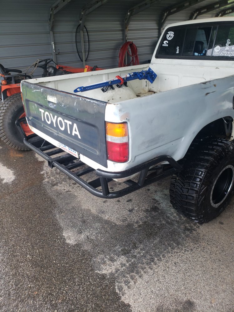

Wanted to LED turn signals and brake lights . Front OEM are gone due to bumper. So I added some 3/4 led from Amazon.
Now all I get is a buzzing sound from relay, and soild light (no blink)
I went and got a a ep35 for leds . When its plugged in i get nothing. No lights no buzz nada
