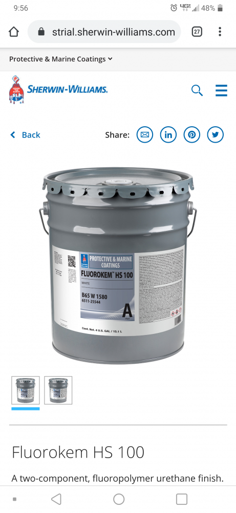

It aint cheap but it's good. And its only made by 1 person in the world and he lives in Greensboro.
