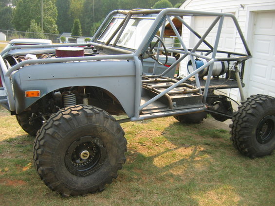

here is the start.

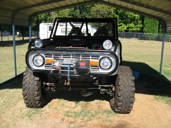

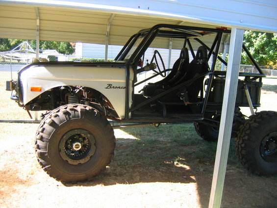

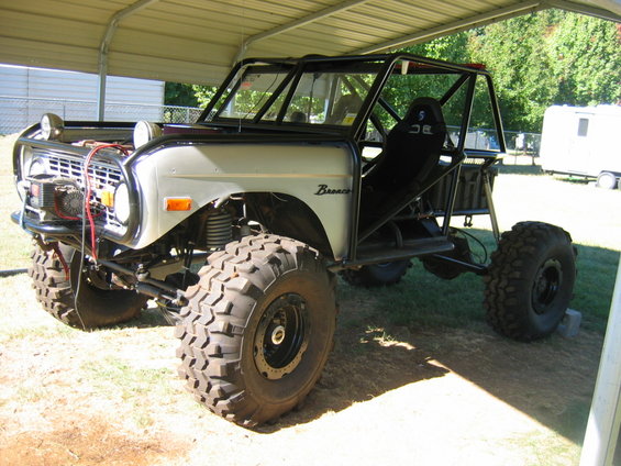

and here it is after.

Looks good Mike. A couple things I noticed........If it were mine I'd put a little more protection around the winch. And 2nd I would lower the fairlead you have on your winch. 15,000 pound winch constantly pulling downward force on the center of the fairlead might break it. They are designed so that the line comming off the spool straight ahead goes through center of fairlead, not up and over it. Easier on the winch also. KC

thanks kevin. i already planned on more protection but didnt know about the fairlead mounting. thanks.

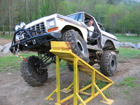

the back over flex's the front so bad that i cant really tell yet. ive only had it out once at tellico. got down trail 4 to go over and hit guard rail and the trans took a :poop: ill know for sure this weekend because im going to ure and i will post pics . a few guys i know run these coils and like them. my other bronco had superflex coils. i know they work good. i have pics of those if you need to see them just reply back. thanks everyone for the great comments.:beer:
