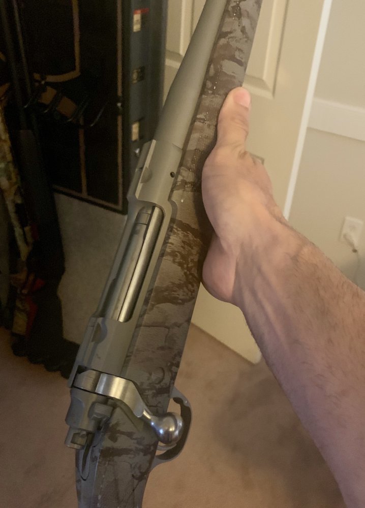

I’m fairly clueless on how to make this look good, but would like to color match my scope to my rifle. The 7mag came with a “flat stainless” coating barrel and rings.

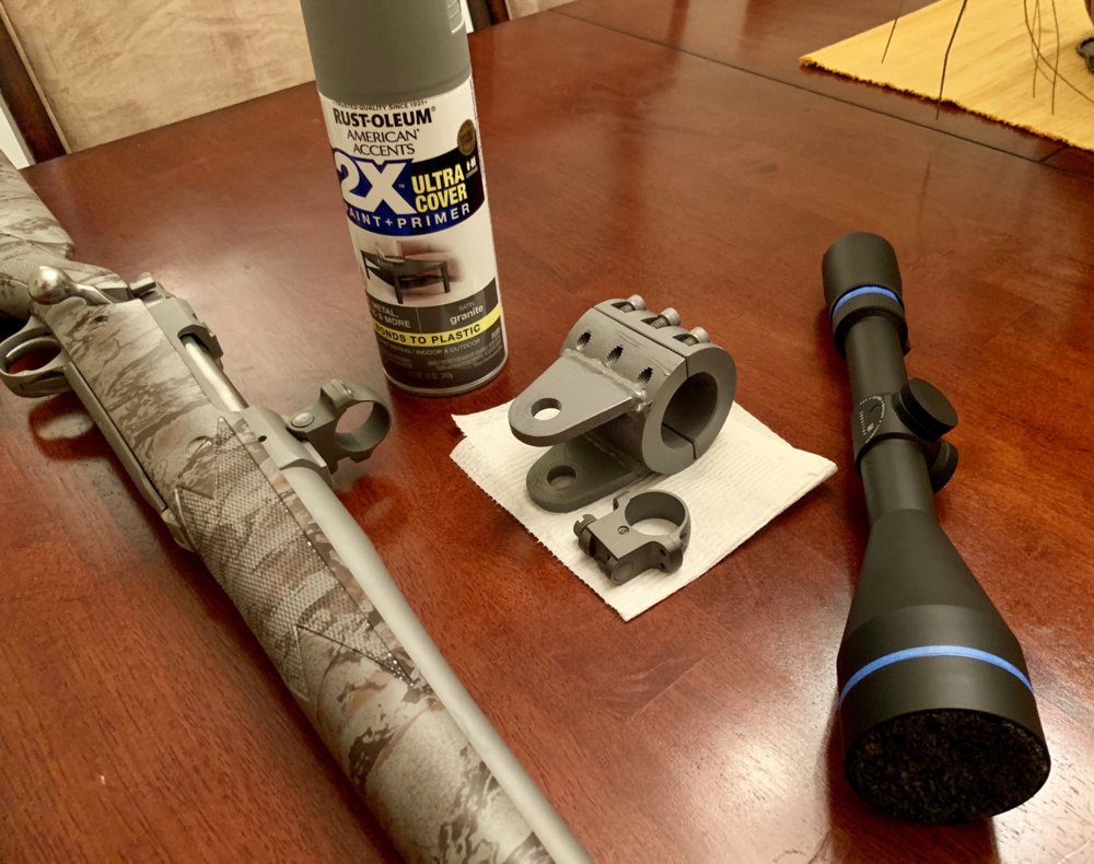

So far I’ve done some shopping around to find the closest paint style to the rings.
Next up was a test run on an old Jeep steering part that was metal and black (closest simulation). After 2 coats and an hour of dry time, I did a quick pass with a wet 1000grit sandpaper.

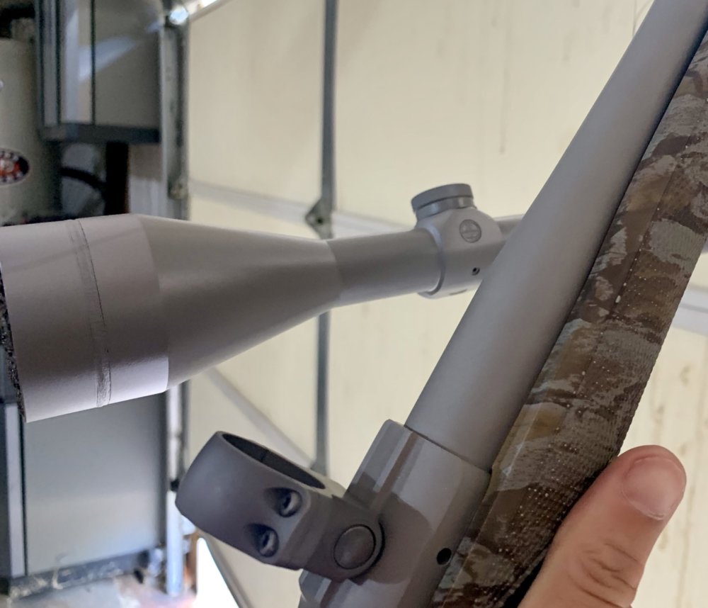

Taped up the scope, then covered up the glass. Not quite sure how I’m going to hang it to paint, but we’ll see I guess....

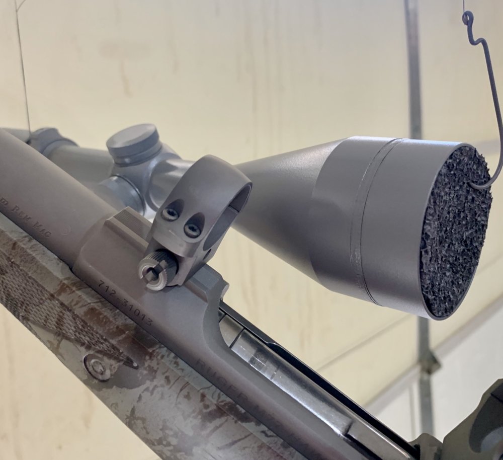

Used the fishing line suggestion. First layer went on perfect. Waited 40 min per the directions and hit it with a second layer.
I’m hoping the sheen fades a little as it dries... but outside of that it’s reeeeally close. Here is a shot of the damp’ish 1st layer. I’ll let it dry for 24 hours and then do another 2 layers.

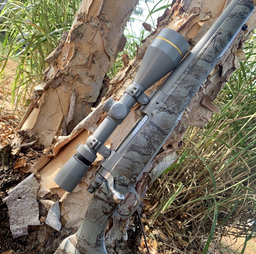

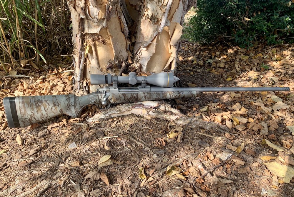

Two coats and a couple hours of dry time. Can’t decide if I’ll paint on it more tomorrow or not...
I think it will have a little more sheen than what I had hoped, but we’ll see after mounting it up.
Looks good. Maybe hit it with some rustoleum clear matte spray paint if you want to dull the finish?
Hmmm.... I may look into that. I’m not unhappy with it so far. We’ll see how it dries over night.
Wow, that turned out nice! Nice choice of caliber too :rockon:
