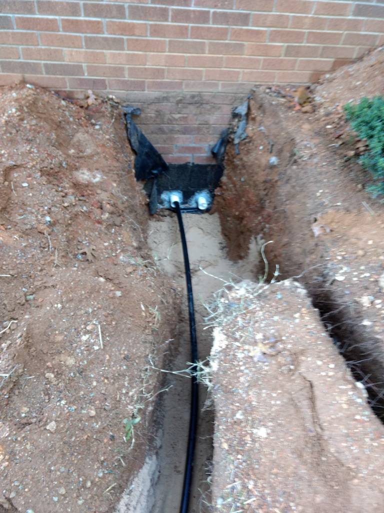

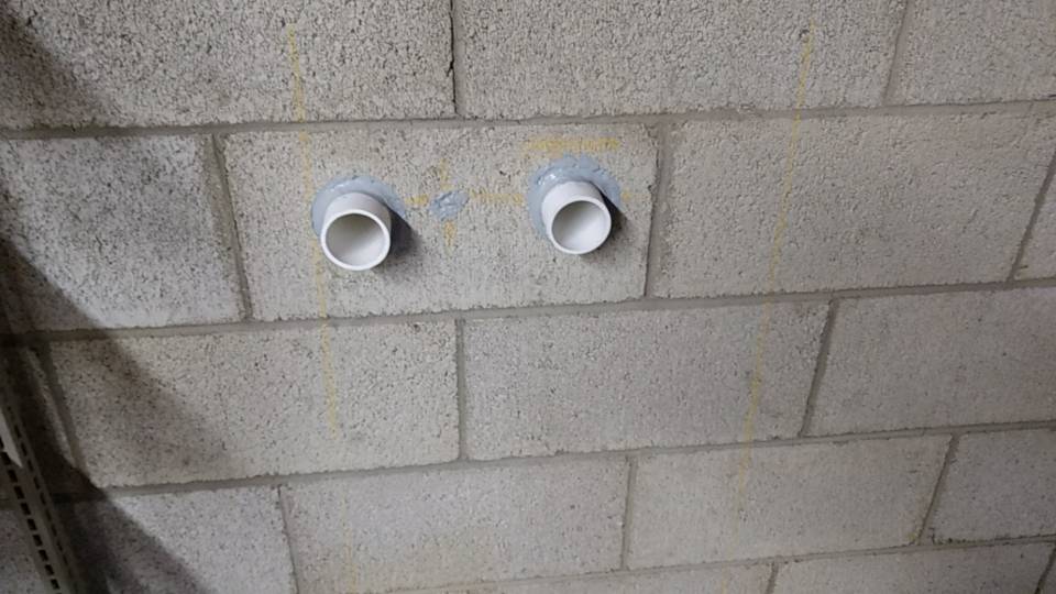

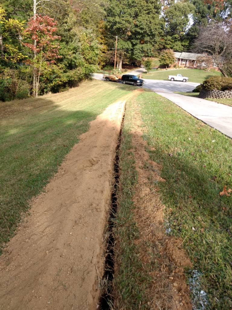

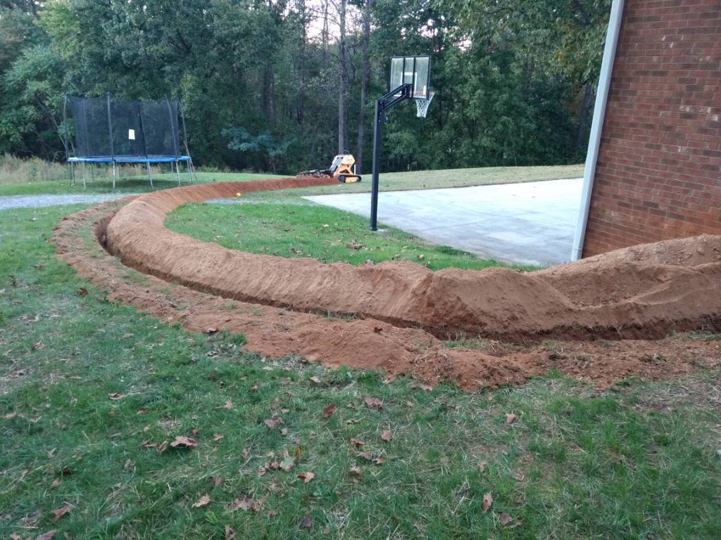

Well, I'm mostly done. I ran my line to the back of my house to avoid the driveway where the original line goes. I just have to move the line across the ceiling in the garage to the other side. Hook that up and hook it up at the meter. Then I have a little shoveling to do. The ditch is filled in now, minus the ends. I had extra line, so I ran one to my shed to plumb air out there from my compressor. Why not!
