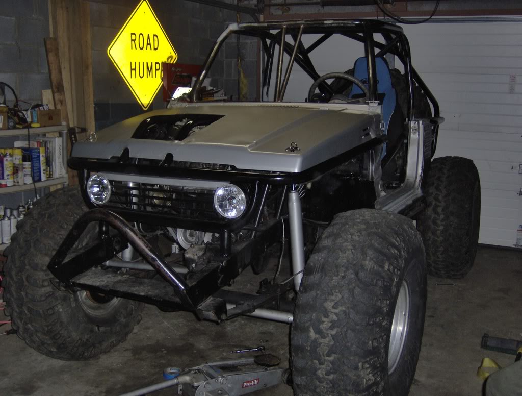

Pic of the ZUKI, in progress....
Punkskalar
New Member
Apr 10, 2005
Boone NC
Im Building it in my 1 Car garage/shop in Boone... My apartment has the space to work in which is nice...
Specs:
SJ410 Tub, Cut in 1/2
Samuria Hood
Samurai Windshield
Homebuilt Steel Fuel Cell, 17ish gallons
85 Toyota Axles: Rear fully trussed, Shaved, E-Locker 4:10's
Front Shaved, Lock-rite, 4:10's, 4 Piston V6 Calipers, Vented FJ40 Rotors
Mickey Thompson Classic II Wheels with OMF Beadlocks, 15x10
39.5" Iroks
3 Bolt Chevy Steering Box, inside frame
Ham Can Chevy steering pump
VW 1.8L GLI/GTI hybrid gas engine: Solid Lifter Head, 10:1 Pistons, forged crank and rods, 268 Cam, A2 Throttle Body, dual outlet manifold, CIS Basic fuel injection, lightened crank
SOS RingeR Adapter
Toyota G52 Transmission
Homemade engine to 1.6 Sidekick Bellhousing adapter
Dual Toy T-cases, with 4.7's in the rear case
YJ springs all 4 corners, spring over
Custom Spring mounts, only about 3" of lift over factory
Tube Front Clip with APC headlights, lowered hoodline about 5" in the front
Fully welded cage/skids etc to the body and frame
Custom framework from the cab-back
Mid mounted radiator
WB is about 100", can't remember right now
Any other questions?

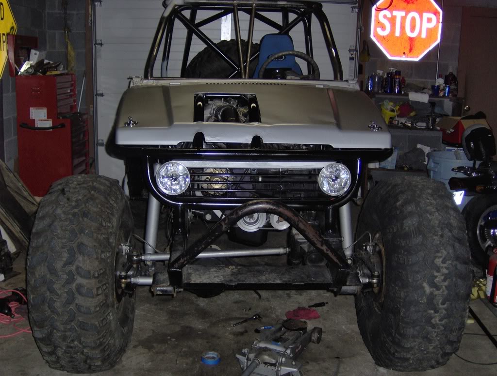

What's up with the hole in the hood? Maybe it's just me, (Just finished doing taxes and my eyes are tired.) but I can't see anything that would be in the way? Looks sweet for sure!
Looks like two hoops for support or something I guess. You can see them in the angled picture, especially on the front lip of the hood where it's notched.
Yeah, I had to lower the VW engine quite a bit from the stock location of the 1.3... I'm thinking about 5-7" below the crank line, you can see how low the crank is in the front pics... Intake and throttle body were gonna be above the hood line, so I built a "hood scoop" out of some tubing to protect when I roll... Didn't want a smashed intake ruining the drive home :driver:
That and the hood is lowered quite a bit from stock, so I didn't have much protection from the front clip without a cowl hoop (under the hood) and those bars going to the front... Looks kinda like the old eclipse bubble hood from the side...
