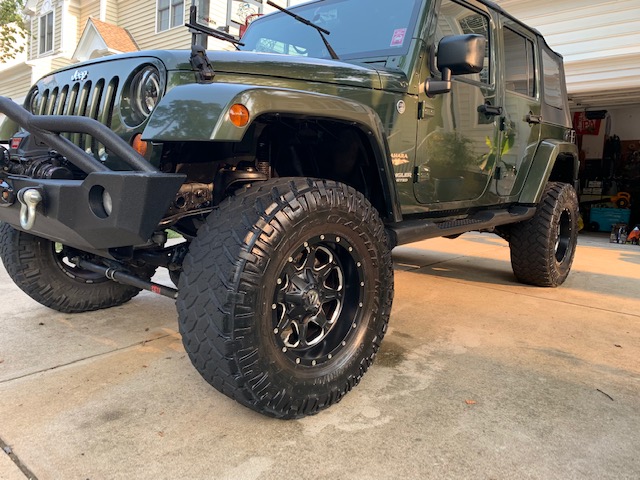

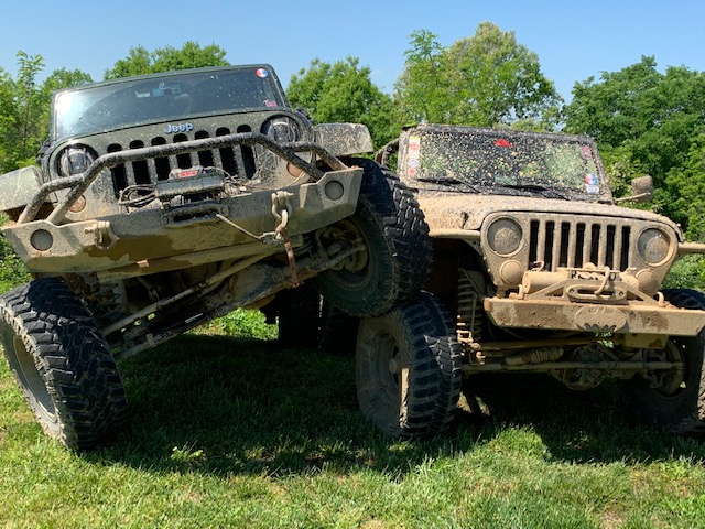

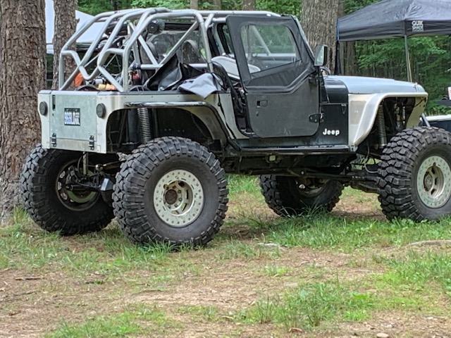

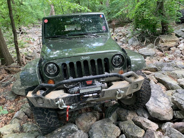

I have been meaning to upload these pics from my build and a couple offroad parks we went to back in 2019. Finally getting around to doing this.

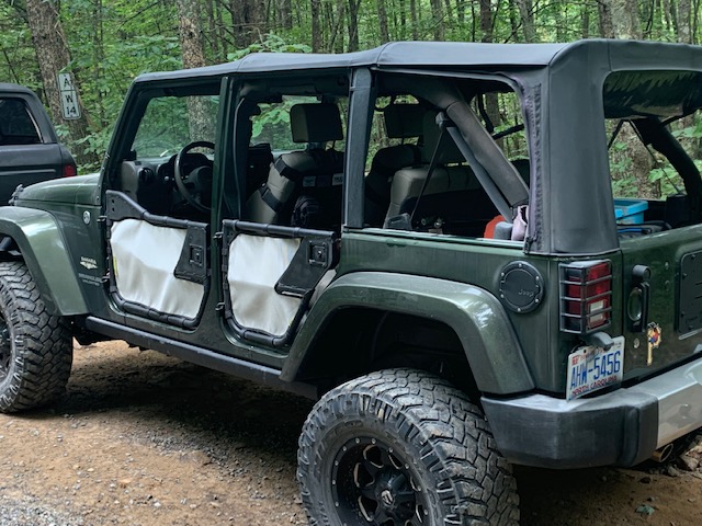

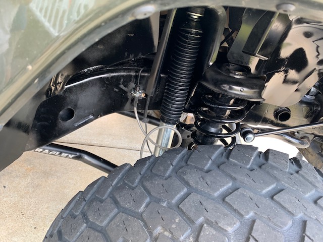

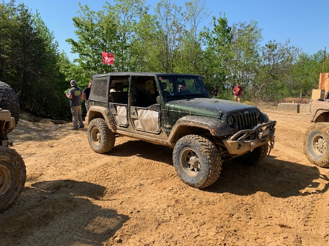

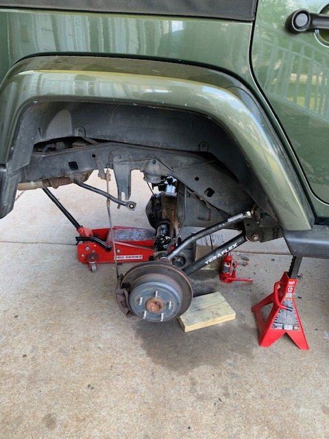

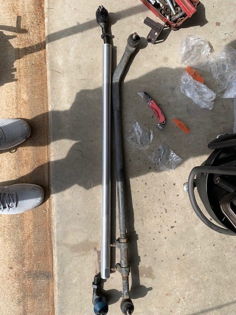

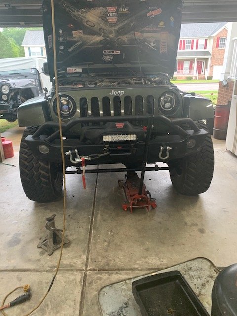

Start with some JKU Upgrades. Went from a 2.5 Lift to a Teraflex 4inch lift with Bilstein shocks. Did the Barnes Track bar, Steer Smarts HD Yeti Tie Rod and Tera Flex Draglink. Also got rid of the crappy gearing and went with the 4.88 gears with ARB air lockers and ARB onboard Air.

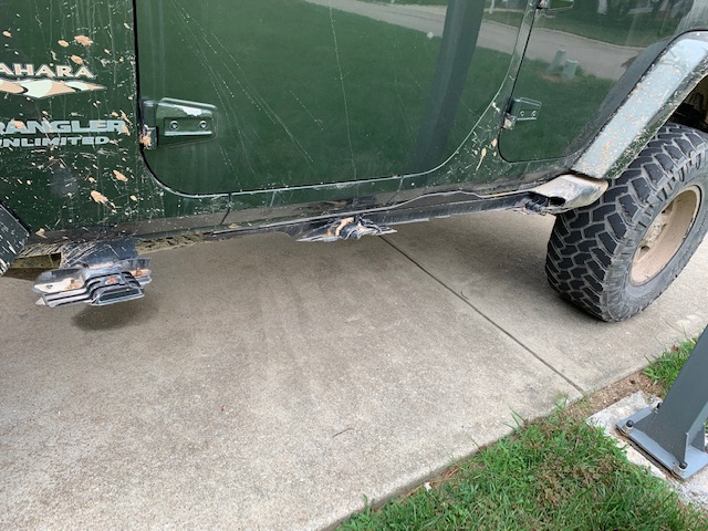

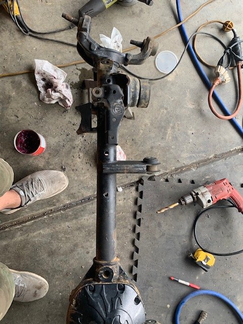

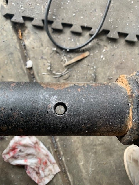

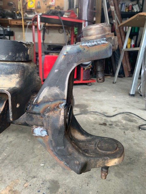

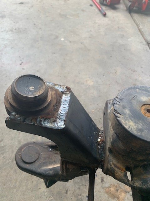

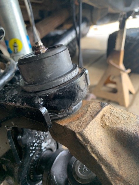

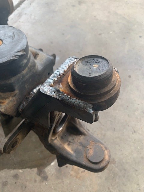

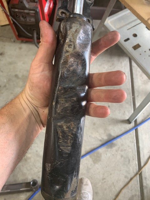

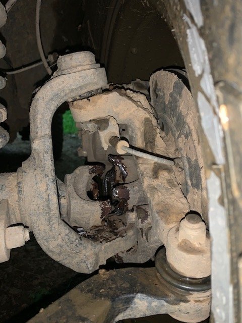

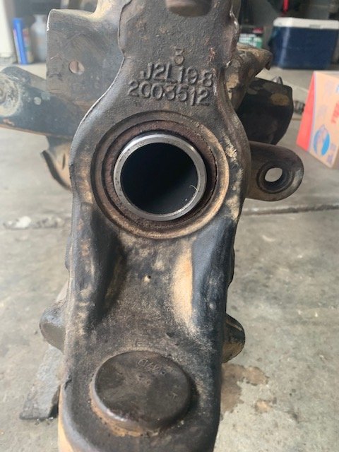

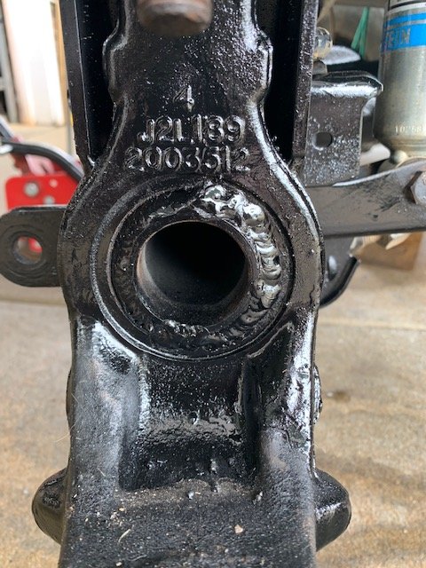

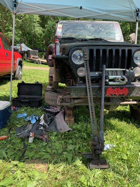

After completely obliterating my front axle at Windrock I beefed up my dana 30. Went with Carbon Offroad Chromoly axle shafts, Barnes weld-in axle sleeve and Barnes C-Gusset. Upgraded ball joints to the Teraflex HD Ball Joints. And got some new rubber Nitto Trail Grappler 35's. Oh and crushed the Teraflex Steering Stabilizer.

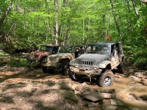

Pics from 2019 Peters Mill Run VA. Oh and my trusty sidekick LoLa my Dog, trained her from a pup to go wheeling she what I can tell loves it.

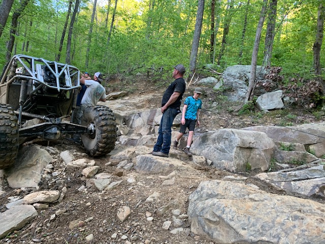

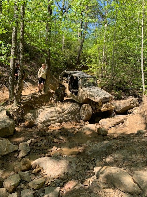

Windrock TN Amazing Park to check out.
