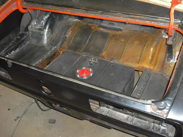

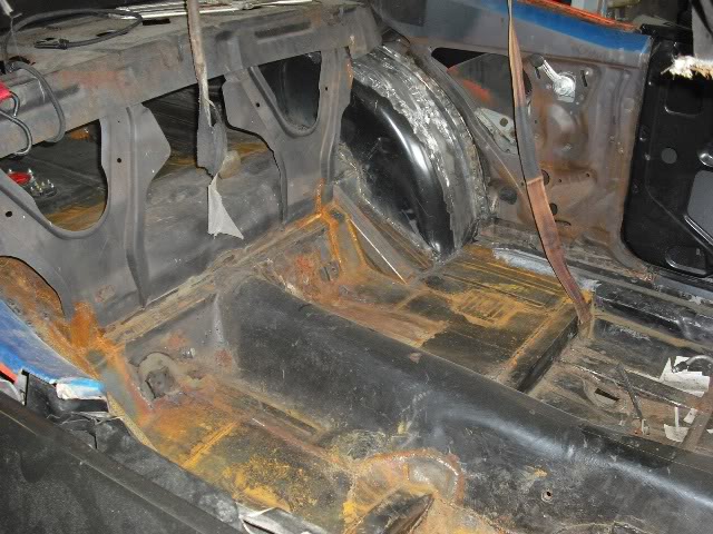

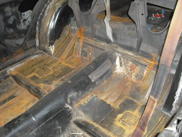

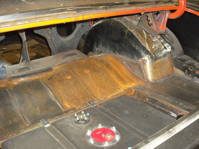

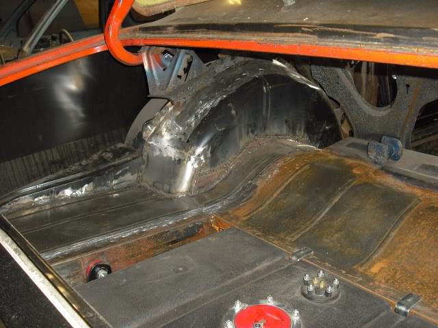

Work has been a bit slow on it, but it is coming along. The guy doing the metal work had some other work he had to get out, but he's been working on the Camaro as he has time to. He's finished up a ton of it. The trunk floor is fabbed and installed, the rear has been minitubbed 3", the rear seat area has been all fixed up, and he's now getting into finishing up the final welds, cleaning up some of the welds, filling in some seams, fixing a bunch of the gaps and things on the car, and basically getting it ready for me to start getting it ready for paint once it gets back to my shop.
