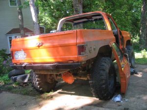

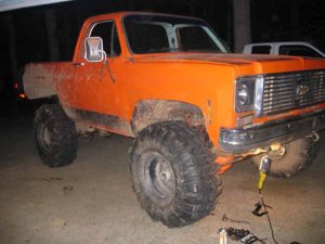

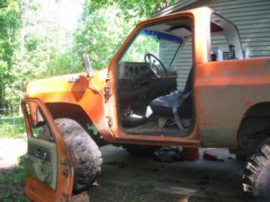

well its not really new to me now, ive had it about 3 months. specs are
-D60/14 Bolt out of an '85 CUCV, detriot in the 14 bolt
-350 with some stuff done to it, i can really only guess about the internals because i dont have all the documentation for it. its got Hedman long tubes on it and some high capacity oil pan is about all i can tell without ripping it open
-TH-350, shifts awsome, reall stron tranny, wish the stall was lower though.
-Np-203, i hate this, i want a doubler or a 205 asap
-39.5x15x16.5 TSL's
oh yea....and its my DD :driver: :smokin:

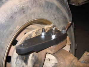

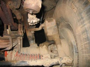

more of my scary steering that is going bye bye ASAP and getting replaced with crossover courtesy of WFO

Sweet K5. Who'd you swipe it from? Whats wrong with the steering block? You could twin stick that 203 and make for better/easier gear selection. Thats the only reason I dislike them, the crappy factory shifting linkage.
got it from a user on the old board, CBurgin. i dont like extra stress on my steering studs if i can help it and a 3in raised block does just that. the 203 sucks cause its full time, so i leave my front DS out unless im wheeling somewhere. and its chain driven. we had a big discussion about this on the old board.
