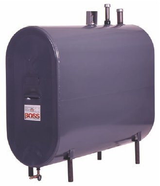

pretty sure this is going to be a PIG COOKER. i doubt a hog will fit in a 55gal drum regardless of how you turn it. id imagine that he has a fuel oil tank like this one
actually, it's a round tank, 36D by about 50" long when I'm done with it.
gotcha. we always used old fuel oil tanks like the one i showed. i have a tank of similar dimensions to what you're using that i plan on turning into a cooker for myself. i got it free in high school but just havent had the time to do it. i need to wait till my dad gets another order of steel so he wont notice when i sticky finger a few pieces of angle iron :lol:
