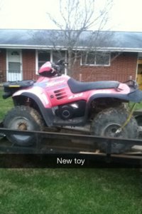

So a family friend gave me this after he got a rhino. Its a 96 polaris xplorer 400 4x4, its a two stroke. :D he only rode it maybe twice a year since 05 when he had a bad wreck on it at coal creek. i knew it was gonna need a battery, and a new chain when i got it.
we pulled the carb and cleaned it. pulled the plug and it was dirty but still worked will replace it later. still didnt have a battery so we used the pull start. it started right up lots of smoke but its a two stroke lol. so now that we knew it would run we looked it over and realized that i needed to replace all three chains and drive belt.
