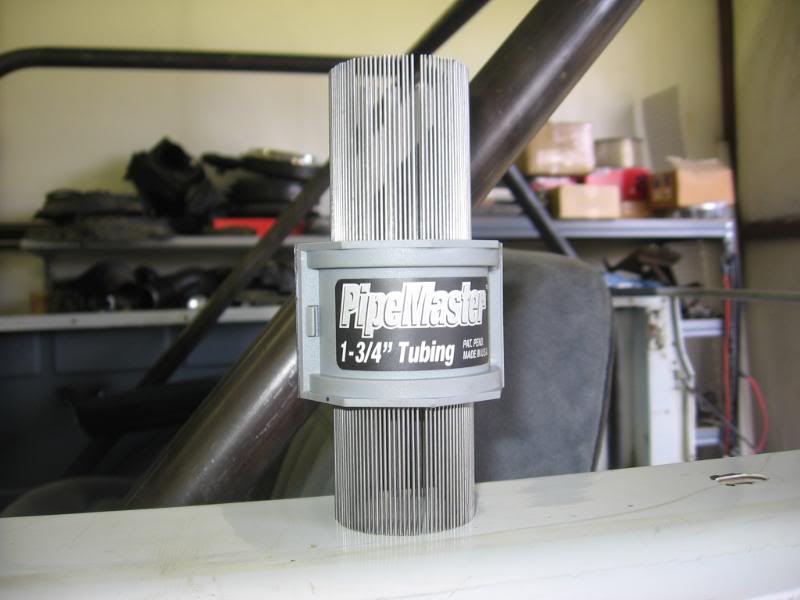

i saw that in petersons in this months mag..
i was wondering how well it workedd
comes in handy

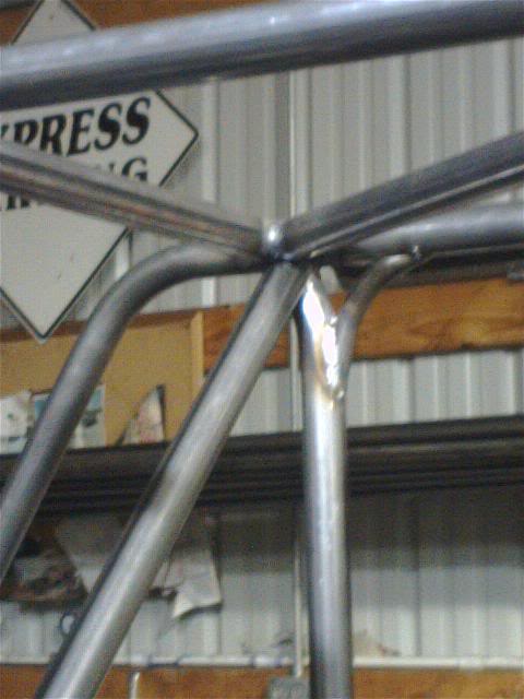

I never use mine. They spread out on the tube instead of conforming to it. Got them from the g/f for christmas so i dont feel too bad about it but its def. not worth the cash. Use them only on REALLY crazy notches and then i just conform it myself and make it fit the angle.
I think this was the last notch i used it on. :D
