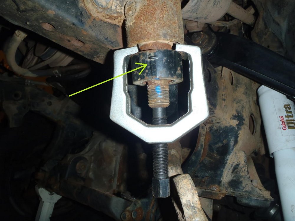

I just tighten the puller with a wrench or impact if it'll fit. It doesnt have to be super tight. Then smack the pitman arm here nice and solid with a hammer. It'll make your puller last forever. The shock will jar the splines just enough that pressure from the puller will free it right up. My puller is one of the cheap tools in my box that hasn't had to be replaced with quality tools. Probably done a few hundred arms with it over the years. This method works with TRE's as well. You should never NEED an impact on this type puller.
