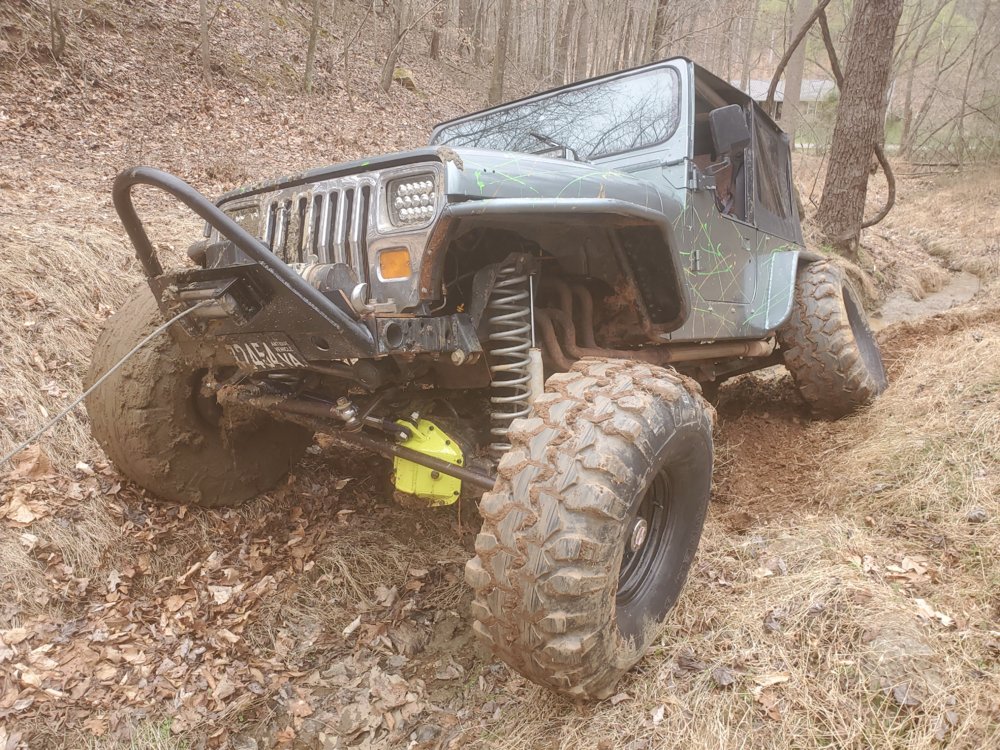

so I am looking for a pitman arm that is around 6.5 inches center to center but points UP instead of down like most do, I'm running an astro steering box and try to get more clearance without moving the box... if that is possible

Waggy arm is dimensionally what you need, but is flat
Is the Waggy arm truly flat? I've heard its flat, then I've heard it has a 3/4"drop then I've heard it has a 1 inch drop.. I'm currently running a stock 78 f150 pitman arm which has about a 1 inch drop.. i really need a 1-2" raised one
Chop it, flip it, weld it, brace/reinforce it.
As far as I know pitman arms are cast steel. Burn it in hot.
Turn it upside down and run a heim.
I cut my astro van arm up and welded to it to make it double shear for mounting a heim. Also could make the length exactly what I needed to match my hi steer arms to get the most travel out of my 60 knuckles.
